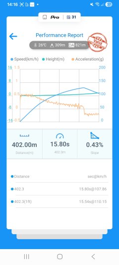

Acceleration runs with 10Hz GPS 340bA and 630pA at 80V = 27kw.
Battery was not fully charged and cold, because the heating controller died. Will also change to BMS with integrated control for the heating.
0-80km/h
0-100km/h
The start ist still slow, in the first two seconds you can feel the motor tourque rising.

I made a test ride. From start it now pulls like a real motorcycle, that is what I wanted it to be.
1200pA and 400bA
0-80 km/h
0-100km/h

New test ride, with wheel spin shortly after the start. 0-100km/h.
You can see the controller restricting phase current at 30km/h because I have limited the battery current to 400A.
