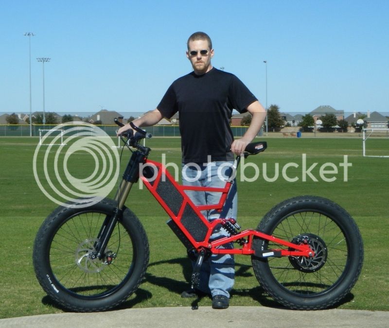

This is the first chance I've had to get out in the sun since finishing the bike. Thanks to... No, make that Huge Thanks to Justin, he diagnosed the CA problem. seems I had one of the batch with the inrush resister issue. I replaced it this morning and the CA is also alive.
And I got a few surprises from it. Seems my tire Diameter is 91 inches, exactly. And the CA, using 12 poles, says I'm going 39.7mph top speed at 75 volts. No wonder I was keeping up with traffic. I want to confirm that, though. I need to find a radar sign or something.
No idea what my amp draw is. I haven't calibrated it yet. and blah blah blah, you want to see pics, not read this crap. So here's a few.
Just for reference, I'm exactly 6 foot tall. 183cm for the rest of the world. This bike makes me look small

It's so beautiful there's nothing I can even complain about. Just to nitpick (and I mean REALLY nitpick) you could think about a chain guide to help with the slack of the chain there.. other than that, WOW.

Idler gear. it has a chain tensioner already where a derailer would go. But an idler at the mid point might be useful. I've already got some chain slap there. A chain slide might be a simpler Idea, though.
