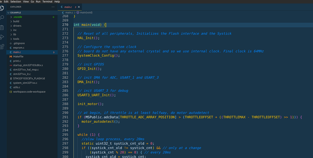

Ok, that is a good idea as you just need to replicate what I did and because is a simple / small example, it should be a safe bet.
Which pins are you using, on init_motor(), that are different from the ones on the example??
The very first thing you need to do is the motor_autodetect() -- use the debugger, put a breakpoint on line 292 and 295. Make sure it goes to line 292 motor_autodetect():
good hint, not aware autodetect happened at half throttle position. I do the same and my power supply collapses with a big bang :shock: I need to change to a bigger power supply.
is there any default setting variables I can put directly? I know my motor parameters and phase angle/shift.

No, the autodetect should work.
You can also check the hall sensors sequence, by debugging the code and make sure the throttle is never enable, you can rotate the motor by hand and see if the switch (ui8_hall_case) follows the expected sequence (use a breakpoint there to see the ui8_hall_case value):

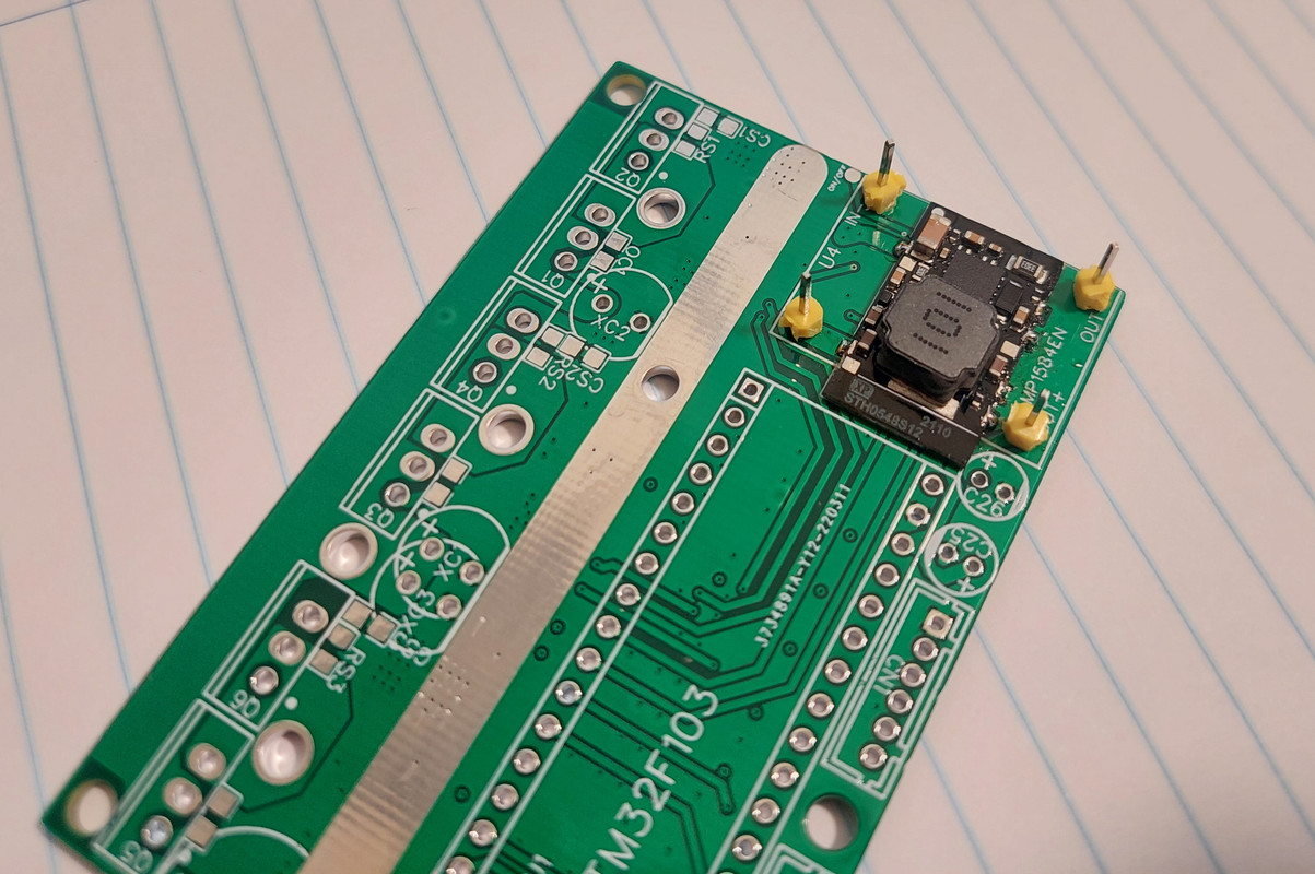

The new PCB arrived and is very small!!
Let's see if in next days I slowly start to building it, as I am short of free time:

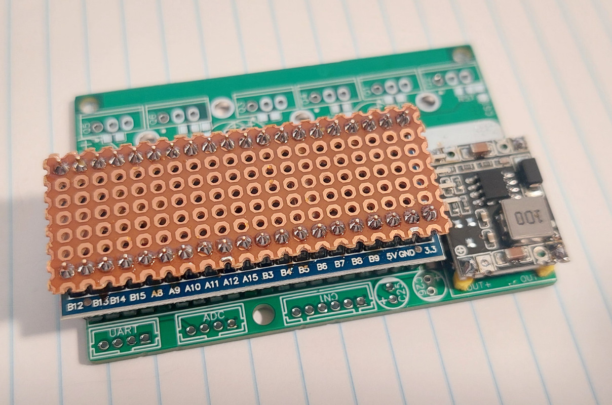

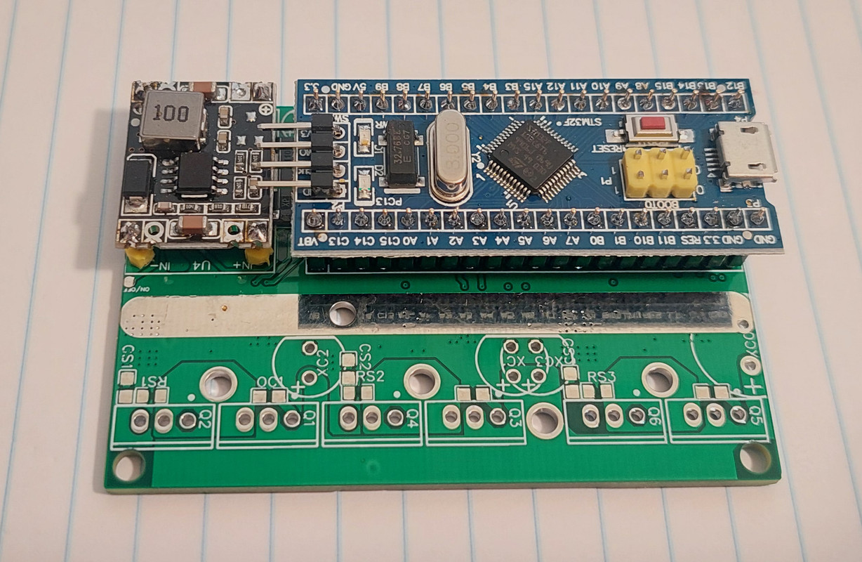

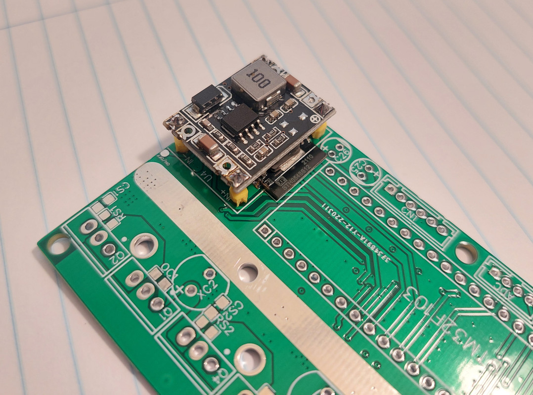

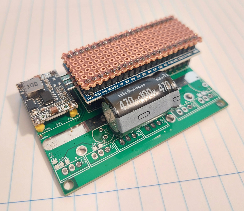

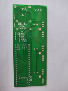

I started assembly the board, I removed the DC-DC boards from the previous board prototype. For now, everything seems to be ok.
The perforated board is placed on top of Bluepill STM32F103 board. On this perforated board I will be able to add any custom electronics:

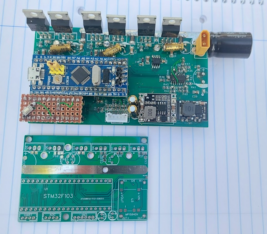

I am missing some components that I will buy tomorrow and hope I will get them by the end of the week. Current state:

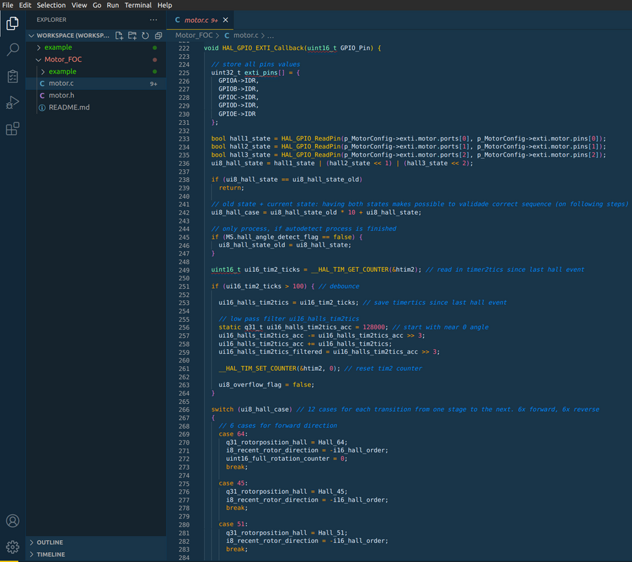

my 2nd round try, one of the hall damaged last time, so I have to use a small motor, the EBiCS_motor_FOC example firmware works fine with autodetect, however compared with the current vs. a simple firmware using ST MC workbench, the current looks bigger at the same speed.
Can you provide a detailed comparison? How much is the difference at which speed? We did a lot of tests with V2 and V3 on the telegram chatgroup, be we never found noteworthy differences.

Can you please share more pictures of the board, from bottom layer also?? I would like to compare with EasyDIY ESC, maybe we can learn from your board!!
this version is for prototype test only since I'm not very confident to design a full power board. it is intended for 2A max battery current only, my purpose is to test and learn all the versions, I will design a final version based on this test board. not sure if it is any help, if you need more detail please leave your e-mail, I can send you the original Gerber file.
