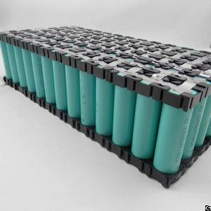

jumpjack said:
This is a "battery":
The difference is made by these:
As far as i know those stackable cell holder are rarely used on DIY e-bike batteries because they are quite expensive, take up more space and you cannot weld large nickel sheets for series and parallel connection at once as you can with the honeycomb design.
In terms of stability or flex i usually glue a honeycomb battery together with Sikaflex or other PU adhesives, and using GFK plates on the sides. It holds up well.
IMO the battery from izeman is build very well and there is no need for a "warning" :)
