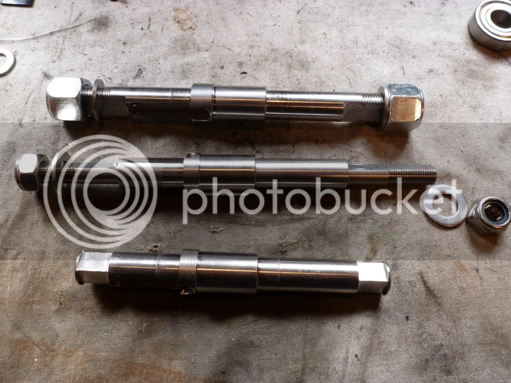

Yep, you really see how soft they are when you push them out. Perfectly adequate for their intended use but not at the power levels and off road use we put them through!! I have even pushed them on the 17mm dia section when the threaded part has broken off and they still mushroom up! The later motors seem to have a machining fault on the axle, the key groove is on the wrong side, it should be opposite the wiring channel, early ones where and did have a key. I have never heard of one slipping, but the key gives peace of mind.
I have made several new spindles for myself and others that have broken them, I use EN24T which is a very tough steel and put the keyway where it should be so a key can be installed.
These axles are all modified in some way, top one is for a 40 series with 3/4 unf threads, next 2 are 35 series axles, one extended and thread size increased to M14, the bottom one is my own, made in Titanium and fits in clamps, no nuts. And all of them have the journal size increased to 3/4" and bearings swapped for 6203 3/4 2rs sealed bearings.

I have been selling them, either with modifications to the users spec or as a direct replacement.
I was considering spending a bit more on a cnc batch to get unit costs down to make them cheaper. The problem is fitting them is not a simple diy task either!
