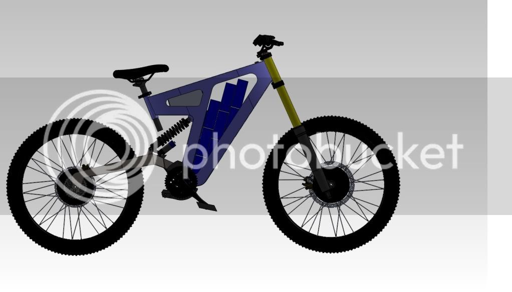

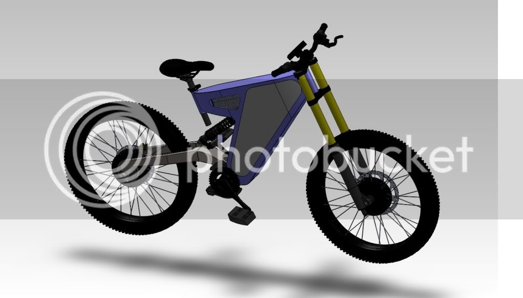

New electric mountain bike frame by Phasor Cycles
Hyena: I would much prefer something like this.
We can do that, no problem. I do like the way that looks too, and after a quick rearanging, all of the 72V 30Ahr pack still fits, even with the big kelly controller, but there isn't room for much more, and of course it moves the center of gravity up. The rear section under the seat can be sealed off from the batteries so the controller can be vented with the underseat frame cutout.
Or we can just have the panel seal off the whole enclosure to conceal and protect everything. If you look closely you might notice something else we are working on..
Spacey: make sure there is enough clearance for the pedals on the ground :)
We did, there is about 3.5" ground clearance at full bump.

miro13car said:
there is problem here.
If you built prototype why do not post pictures of prototype , why AutoCAD dreawings??????
Having followed the build thread for the prototype of this bike, I can tell you the prototype has a significantly different frame. The CAD drawings are of the frame that will be made for sale. Having seen what these guys can do, I am sure they will produce a run of these bikes. I hope they can make enough to make it viable if not a bit a of profit.
Check this thread for the prototype
http://endless-sphere.com/forums/viewtopic.php?f=6&t=24253

If you guys could show an actual physical prototype I reckon that would have a huge impact on sales. Presumably you should make a prototype in any event to prove that you can do it within cost specs, but I think if people could see the real world example it would make a big difference.

Prototype 1 was carbon fiber... Did you happen to see read the first post, click on any of the links?
Yes I saw that link and I had read that thread at the time, but that frame is a monocoque carbon frame, it is totally different to the proposed frame, and so what I am saying is I would be interested in seeing photos of a physical prototype of the proposed frame.
Philistine,
We are currently racing to get the first production frame made. We have the Jig about 80% done and we have all the materials ordered. We will be sharing pictures and more details with the ES forum once we get the first production frame done. And like all good products we plan on doing a fair amount of testing before delivering the first frame. That is one of the reasons our proposed availability for the frames is late 2011 / early 2012 as we said in the first posting.

danimal said:
The frame is constructed of TIG welded chromoly that has been precision waterjet-cut, making a capable light weight and versatile frame. It has been designed to hold the batteries low and centralized.
1) Please explain why you switched from light weight carbon fiber composite to heavy Crmoly?
2) Did the carbon fiber prototype have any issues in the design, construction, or durability in field testing?
3) What is the total weight difference between these two bikes when using same weight components & parts using Crmoly vs Carbon Fiber?
Look forward to the testing & final design/weight before I can commit.

We are shooting to be production ready by Jan. - Feb 2012, pending field testing. This means we plan to start building them as they are ordered around this time.
Have you investigated shipping costs yet?
We will be using UPS to ship, you can get an estimate from their shipping calculator, coming from zip 90278. The package will be approximately 35 lbs, that is a liberal estimation.
1) The main reasons we switched from Carbon Fiber to Chromoly, as mentioned by Alan B are cost and labor. Expensive material, expensive and time consuming to manufacture. Lots of one off parts. Harder to repair. More complicated to scale up production. Relative to working with steel, it's just kind of a PITA in my opinion. We see the DIY market wanting something cheaper, and easier to customize (weld on) even if it is at the expense of weight.
2) Issues in the design, not really except a clearance issue with the rear tire / rear shock that luckily was an easy fix. The construction went smoothly, albeit time consuming and messy. As for durability in testing, There was minor surface cracking around one of the swingarm pivot mounts in the frame, but it is still strong and structurally sound, nothing that would make me hold back on anything for fear that it would break. The carbon fiber is very strong, but one good tumble into some rocks could destroy the frame, and it wouldn't be easy to repair. The geometry has been revised, to give more leg extension for pedaling, a lower seat height, and a more slack head tube angle. We destroyed some rims jumping out of a 6 set of stairs, went through a one way bearing from the older generation BMC motors, broke off the derailer. Those are the only issues we have had with the bike so far, and it has taken some beatings, including tumbling down a steep hill for about 100 feet (luckily I didn't go with it haha). One of the dropouts in the aluminum swingarm are getting a little thrashed, since after welding the derailer mount back on the aluminum is back to soft 'O' condition in that area from the heat of welding and not re-heat treating.
3) The total weight of the CF frame was 9.0lbs, and the swingarm was around 3lbs I think so about 14lbs alltogether. The Chromoly frame is expected to be around 16-20lbs with the swingarm. However it is designed to use mountain bike suspension, which all together is about 18lbs lighter than the heavy motorcycle suspension used before. The Carbon Fiber Prototype was 90lbs with a 72V, 10A*hr battery, and BMC motor. Using the same battery / motor in the new model would end up around (90 + 7 - 18)lbs = ~79 lbs, but since we are using more batteries in this test model it will probably end up around 90lbs.
We are getting very close to building this first frame out of the new jig, we hope to have some pictures of a physical frame for you guys soon here..
By doing this you seem to come to about the same weight as the Carbon Fiber frame that has heavier motorcycle parts.
1) Will the durability still be there using Mountain Bike components vs Motorcycle grade components? Any downsides to doing this where there might be some limitations that the motorcycle components could handle but the mountain bike components will limit or prevent? Higher cost for mountain bike parts vs motorcycle?
2) Any Pros/Cons or trade-offs worth mentioning beyond the weight savings by using mountain bike parts vs the motorcycle ones? Will you be heat treating the finished CrMoly frames after welding for "stress relief" too?
3) Are you doing the actual manufacturing yourselves, or are you contracting this out to a fabricator?
