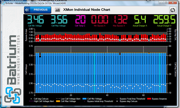

I haven't read through all the pages here so pardon me if this has been mentioned but although not open source I don't see Batrium mentioned in this discussion. Pretty much belongs in any discussion where powerwalls come up.
https://www.batrium.com/
undefined
Yes, those batrium system seems to be better oriented toward solar/storage application. The web app user interface is nice for remote viewing and wifi is included. Their hardware seems to offer quite a large cooling capacity for balancing large packs.
The BMS hardware presented in this thread so far have been mainly oriented toward electric vehicle application.
