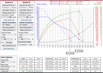

I know just enough about the winding of hub motors to be dangerous. It is my understanding that 26” wheels normally use a standard wind motor, but 20” wheels normally take a fast wind motor.
The G020 motor seems to work fine with the smaller 20” wheel. With the smaller wheel, the top speed is reduced from over 25mph down to just 20mph. However it seems to be quicker off the line, and is a great hill climber. Overall a good tradeoff for the type riding I normally do.
I was expecting similar performance from the Bafang CST motor. As I received this used, I don’t know how it was used (or abused) in the past. In comparison to the G020 is is still a good climber, but not as good as the G020. It has even a lower top end of maybe of 17mph. While I could live with this as my “off road” trike that seldom see’s speeds above 15mph, there is another issues.
While climbing at speeds below 7mph, the motor is nice and quiet. However, at over 8mph the motor emits a loud whine. It is loud enough that people can hear me far down the trail, and the noise is distracting from my ride enjoyment. I am thinking that the CST motor does not like to be pushed at higher rpms which is happening by using it with a smaller wheel. While the G020 motor also gets a little louder at higher speeds, it is nothing in comparison to the CST. In the case of the CST motor, maybe it should only be used with a 26” wheel.
So what to do? I have been able to find a new G020 motor, and I can get it for either a 20” or 26” rear wheel. My inclination is to get the proper 20” wheel model. This should provide more top end speed, and provide smoother power delivery for general riding. The plan would be to use this 20” motor on my group ride trike. I would move the current G020 motor to my “off road” trike where the better climbing and lower top end speed would make more sense.
While these seems good on paper, maybe I’m missing something. Any suggestions of comments would be welcome.

Thanks for the help. Perhaps a bit more information...
The standard wind Bafang G020 that I am happy with is a 48w 500w geared hub motor. It is mated to a KT 22a controller and a 17.5ah battery. (original Bafang controller was 18a) Even though the motor was taken out of a 26" wheel, it works great for me in a 20" wheel. Top speed is limited to about 2mph, which is fine with me. I much prefer the good climbing capabilities.
The standard wind Bafang CST that I am having issues with is also a 48w 500w geared hub motor. It is mated to a KT 22a controller and a 14.5ah battery. As mentioned it is nice and quiet up to about 7-8mph where it starts getting very noisy and will not go above 17mph.
Both motors are fitted to near identical recumbent trikes which have a 10 speed rear cassette and a triple crank.
Since I am happy with the G020, I makes sense to use replace the problematic CST motor with a standard wind G020. This way I will have identical motors that should perform the way I want. As an additional test, I will be replacing one of the 22a square wave controllers on one trike with a 25a sine wave controller to see it this makes the motor even quieter.

I have done more riding with both motors. Is the noise more electrical or mechanical? Kind of both with the CST motor. I generally ride in PAS level 1 and 2 (out of 5 levels).
The G020 motor makes more noise at higher speeds (RPM), but the level is acceptable. It also makes more noise the higher the PAS level. Again the noise level is acceptable. The noise is the typical gear noise you get with a geared hub motor. I will be trying out the sine wave motor as soon as I have a chance.
With the CST motor, the noise level is acceptable at low speeds, but as speed increases to moderate levels the gear noise and electrical noise both seem to increase dramatically. My uneducated thought is: (1) There may be a mechanical problem with the motor that shows up at higher RPMs. (2) The controller may not be very compatible with the CST motor. (3) the winding is slower than the G020 motor. There is plenty of low end power, but it fades rapidly at higher speeds and there is a lower top speed. (4) All of the above. I plan to test the motor with the old 18a Bafang controller and the new 25a sine wave controller to see what difference that makes, if any.
Geared motors are typically very noisy and inefficient in a 20" wheel.
I have not seen a single one designed with the appropriate gear ratios for smaller wheels.
An additional problem is that the gear friction is now much higher per RPM than it was designed for. When cruising on the flat ( which you're doing most of the time ), this shows itself as reduced efficiency. In some motors, this can cause the motor to overheat at low speeds. The MAC can handle this OK, but it's a big motor. Smaller motors can have bigger problems.
You can also run into issues with the electrical RPM being too high when you run fast windings with geared hubs. MACs have this problem, so previously, a modified infineon was sold that could handle the high eRPM. Few controllers can handle it. Controllers that can't handle the high eRPM will stutter somewhere north of 25mph.
In other words you're far out of optimum conditions for this motor. For a 20" wheel, a DD the size of a 9C 27mm or smaller is recommended.
