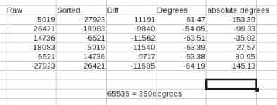

Makes sense considering they are not that precise in other aspects of the motors. I guess even a mm error is significant in terms of electrical rotation on a hub motor.fechter said:I'm sure they're not super precise when they install the hall sensors in those motors and some phase error is highly likely. This could cause significant losses if they are off by a few degrees. Synthesizing the hall signals with a PLL might be one way around this.
Ricky_nz said:Makes sense considering they are not that precise in other aspects of the motors. I guess even a mm error is significant in terms of electrical rotation on a hub motor.fechter said:I'm sure they're not super precise when they install the hall sensors in those motors and some phase error is highly likely. This could cause significant losses if they are off by a few degrees. Synthesizing the hall signals with a PLL might be one way around this.
I'm hoping to use the PLL to provide angle reference for the vector control as an option but a similar technique could be used on simpler controllers. I'm not sure how the guys with the timing adjuster project handled it.
I've got a bit more debugging to do as my PLL seems to be locking on at the wrong frequency.
Thanks Lebowski,Lebowski said:I don't use a PLL as it takes too long to get lock. Plus a reliable lock detector is difficult.
Yep using the 6 edges is good and the PLL would have never been accurate at even those points unless running at a very constant speed which is not really reality, especially on a bumpy offroad situation.Lebowski said:I like this better than a PLL as at each of the 6 hall edges the phi is dead on. Also the response to speed up/slow down
is practically instantaneous (when the next hall edge comes). You don't need a lock detector to decide whether the PLL is
in lock and whether it's output makes sense.
Being vector control mine needs an angle all the time a probably higher accuracy.Lebowski said:The only place in my design where I use this phase algorithm is for back-emf sampling during calibration. The ADC's are triggered and the phi
is determined. When the ADC's are done their values are assigned to a bin based on phi (128 bins in 1 e-rotation). After every hall
TCFP is updated. A difference with the previous TCFP of more than 6% and the back-emf measurement is aborted, an
error is reported to the user (excessive slow down of the motor, not good).
