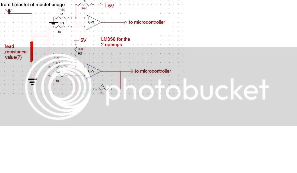

i found a circuit in bldc motor control pcb...for overcurrent detection...im unable to figure out what exactly is happining in it...so please give your valuable suggestions...the microcontroller used is XC846..( if any one could post any document regarding the pin layout and the modules of this microcontroller that will most helpful)...below is the circuit
im using cypress microcontroller for bldc motor control in my ebike model...
everything else is sorted out except the overcurrent detection part...for which i traced the circuit which i have shown above from a pcb of some japanese ebike...it has infineon XC846..for which im unable to find any datasheet or pin config details(if u have any material related to them please post)..and i dont have the code...im trying to figureout the logic and hope to implement in my board...
any suggestions are most welcome...
See Shenzhen schematic section below:
The top amp is working as a comparator and is looking for current spikes. If the current goes high enough, the voltage across the shunt will rise above the reference for the amp, the output will toggle and send a signal to the MCU to kill the output and display a fault code.
The lower amp is used for the normal current limiter function. It is linear and feeds a signal to one of the A/D inputs (guess). The reference level for this amp is lower than the short circuit detector above, and has a much slower response speed.

what will be the current sense resistor value...in your diagram R55....i guess its resistance will be low....but...what will be the value?

Ok. Given the hint I gave you on the other post, you should be able to calculate the resistor value by yourself then! If not, just ask! :wink:
yea we can calculate it from the requirement..
coming to my present issue...im trying to figure out the material used in the japanese board which i m using for reference...so that i can use same material as resistance on my board..u can help me by suggesting the material which is generally used for these applications
I have not measured the actual resistance, but I'd guess it's about 0.002 ohms.
The resistance wire used to make the resistor has about 10 times more resistance than a copper wire of the same size. I do not know the exact composition of the wire or where to get it (other than from another controller).
