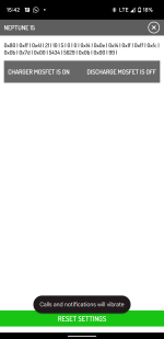

Just received my now third neptune BMS, this one being your Neptune 20. I cannot get the device to be detected via Bluetooth.
My neptune 15 is detected as always, but this is not. The basic light indicates all is ok, all lights remain on and the red light flashes.
I suspect I have a faulty bluetooth module in this version.
@Speedict can you assist?
I just responded to your email.
After restart
The two blue lights remain on, red flashes and green on.
The android devices I am using all detect my Neptune 15, but none detect the 20
can you help to check if it’s lose contact of Bluetooth module ?
just simply use screw-driver to knock on the area which is the bluetooth module located.
sorry about that, we have test each unit before shipment, that’s mean should be bad contact of something else.
we will arrange other replacement this week.

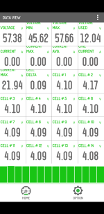

I finally got my Neptune 20 and have it all hooked up am running into two issues I'm not sure how to address.
1) Old Firmware; but No Update
Seems I have a nearly 2 year old version that I definitely see newer versions of from this thread, but nothing on this screen gives me a way to run any kind of update. What am I missing here to get the latest?
2) Balance Charge Quits
If I run a "balance" or "balance charge" the BMS will either disconnect the charger or claim the balance is complete instead of bleeding that high cell (#2) and getting them all in sync. So it's, uh, not balancing. Perhaps I have a setting wrong somewhere?
hi, 1.0.0 is the latest firmware for Neptune 20.
can i have your charge setting ? you can refer to user guide page 14. CHARGE option.
e.g. if the CELL BALANCE DELTA is greater than your pack's cell delta value, it will end balance work immediately.
Danny
That seems to have been it; I reduced that to 30mv and it is now behaving as I would have expected. 100mv as the default seems too high to be a reasonable default.
