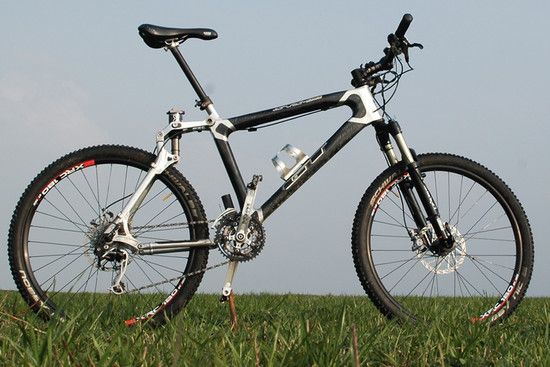

http://www.ebay.com/itm/1990s-GT-RTS-1-Mountain-Bike-20-Aluminum-Full-Suspension-Frame-/320768217859?pt=Mountain_Bikes&hash=item4aaf469303
The best design I"ve seen so far. You could easily bolt your battery case in that triangle securely.
There's a guy with one of these near me, but I'm hesitant since it's so old.
