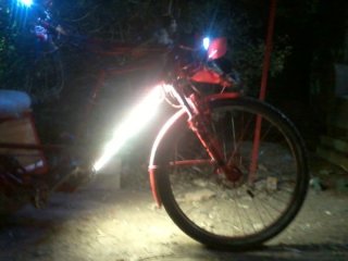

BTW, that headlight looks hella funny. I like it.
When I was first pondering how to use it, I thought it would be stupid looking but once I'd pared it down to just the part I needed to use, it reminded me of all the asymmetrical spaceships and cars I used to design and draw up, and has actually gotten me thinking about an asymmetrical trike design, which would look more like a sidecar on a bike at first glance...but it would probably need an outrigger wheel held just off the ground for turns in one direction. Someday I mgiht actually test the idea; probably I'll just draw it up. But it would be a fancy faired design, not really a velo but sculptured-looking. Something more to be different and striking than practical. ;)
However, I might also draw up a fairing idea around this headlight that would be sculptured in a way to make it look like the whole trike was designed to be like that. (rather than slapdash of found objects, which it really is).
But as wierd as it looks, the headlight works fine in neighborhood test runs--gotta see how it works on my commute home as a real test.

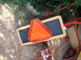

I also liked those chalkboard side panels. Dang... now you got my cranial gears turn'n
They're actually not chalkboard, though they look like it. They are old retail aisle signage from a pet store's natural foods section, and were designed to look like chalkboards, with printing on them that emulated that style of writing. I painted over that in flat black, and then used some cloth paint (all I had that I could brush on) in white, painted on with a zip tie rather than a brush (couldn't remember where my brushes are :lol:), in kind of a hurry before leaving to meet ions82 and pick up that stromer motor sunday before last.

The post I *would* have made today was just to report that I only y got about 52wh/mile again, vs the 62-63 on my previous commutes. But since it was still at the 63wh/mile level on the way to work, the reason for the lwo average must be because of my low speed on the way home.

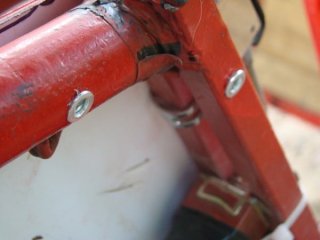

And also to report that the front fender has split in half as if cut, just behind the brake-arch bolt-on point. At first I just couldnt' imagine what caused it, but then I realized it's just thin aluminum, and it hasnt' got a brace to hold it out at the front end, so the wiggling up and down and sideways sheared thru it via metal fatigue.
I can fix it, of course, but before tehre's mcuh point, I'll need to add braces to the front end of it like I have at the rear. or it'll just fatigue somewhere else and fail again. :(
Also, the stuffing behind the headlight holding it up at the correct angle didn't survive the bumpy ride to work, so it sagged down enough to only light the area for about 30 feet in front of teh trike, at best. :(
I jury rigged it for the ride home, but it didnt' stay very long; too many bumps/potholes, so I'll have to rethink the mounting. It does still work the way it is now, just doenst' light the road much better than the old one (though it is much more even).

I redid the headlight mounting today, but it wasn't enough, and the bumps still shook it down over the ride to work and home. :(
I'm probably going to have to just cut the actual tubes going back to the steerer mounting point, and jsut add a pivot and bolt so I can use that to adjust the angle and tighten it down. :/

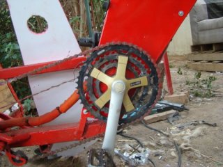

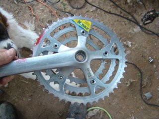

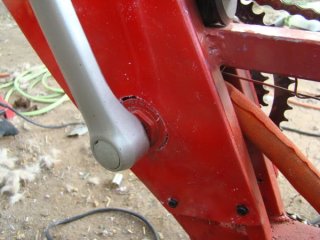

Today I got the sprocket fixed, on the IGH input.
Basically, the way I had it assembled before, the sprocket was held in place only by the clamping force of the bolts holding the sprocket pressing against washers on the bolts between the original input sprocket and the larger one actually being used.
This is because the original sprocket "domes up" where it connects to the IGH, and the larger sprocket's ID is smaller than that dome, so it rests on it, but is not secured by it.
This means that as the torque pulls on the sprocket, it can pull it off-center; this is what happened the other day. Then the bolts were far enough off on one side that the washers popped out from between the sprocket,s and allowed it to get so far off center it rubbed on teh wood panel behind it and then as it rotated jammed against the dropout frame holding the IGH.
To fix this, I used the angle grinder to carefully alter the shape of the inner circumference of the sprocket, so that instead of being a flat disc with about 1mm thickness, it is now shaped opposite the dome of the other sprocket, coming to a blade-thin edge on the ID, so it will now sit flat against hte face of the other sprocket, and can't shift around as long as the bolts are tight.
So the bolts were then reinstalled silghtly differently, as well, so they sit against the "back" edges of the holes in the larger sprocket, so when the chain pulls it against the other sprocket and bolts, the bolts will tighten against it in all four spots.
WIth the sprocket centered like it should be, and is now, and was to start with, it's easy to pedal around the yard, even over several-inch-diameter pieces of palm frond ends that the dogs use for chewtoys, and the 2.5"-3" pieces of mulberry branch they also chew on, and thru the 4"+ deep holes Kirin enjoys leaving here and there.
With it offcenter by the 1/2" or more after the failure, it was very hard to pedal, not because of drag or rubbing, so not sure of exact cause, but assuming that it was because of the offcenteredness?
Anyway, it's fixed now, and hopefully stays that way. I'll have to recheck teh bolts/etc after some rides where I use it in lowest gear to help startup from a stop just before I hit the throttles, so it gets the most torque on it as often as I can manage it.

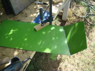

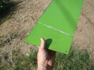

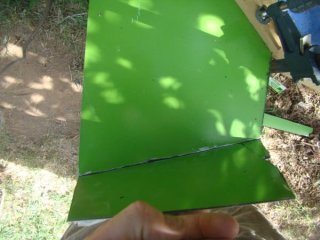

I'm using a similar technique to the one for making the seatbox to start making a tailgate for the cargo area, for use when I'm not using the dog crate or the complete wooden shell I'm hoping to build on my next vacation.
I transport small stuff a fair bit, that I have to spend a while tying down, but would not need to if I simply had a tailgate to keep it from coming off the back.

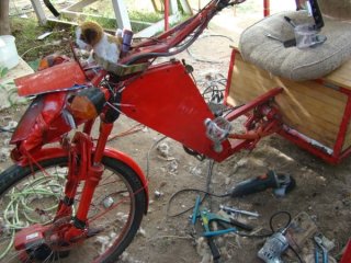

So the front fender has just about driven me crazy with it's antics.
First, it broke in half right in the middle where it mounts to the fork.
Then it kept coming loose and rattling around whenever I made a sharp turn, at the repaired center mount for the rear half.
Then the rear bottom mount to the wire frame (that goes to teh dropouts) ripped thru, so the bolt is still on the frame, so I used a larger washer on the outside of the fender, but that ripped thru the very next trip to work, on the first "washboard" corner, and now the hole is almost big enough for my thumb in the fender.
I've been temporarily repairing it with zipties to secure that fender part to the wire frame, but every time I make a turn over the rough "washboard" corners at various intersections, it instantly breaks *all* teh zipties there, whether they are loose or tight, and whether there is only one or if there are six.
I can't see any mechanism where it would cause this, but obviously something is happening that isnt' visible, and it probably doesn't matter what I do it's going to keep doing this. If I use a bigger washer it'll probably just make an even bigger hole, or destroy the fender completely.
Since the fender is already so damaged, I am just going to take it off for now, and see about building a completely new one on my upcoming time off (along with the bajillion other things I have to get done in that week). I dont' knwo waht design it will be, or what it will be made from, but that will rpobably depend on what materials happen to be at hand at the time.
Ther'es a good chance I'll make it angular rather than round, to go along with the rest of the trike's general geometry.
I'm also looking at finally building that suspension front end made out of a multilink rear suspension frame and some double-crown clamps and steerer, and whatever tubing will fit those.
Then I'll see if I can also fit teh old rear Fusin 1000w geared hubmotor in there for a front wheel, just to see if it helps acceleration any, and also to see if it is capable of pulling the trike at all, withotu damaging it. (by itself, as a backup)
I'll probably have to use a bigger / DD motor there instead; but we'll see. It's just another experiment anyway, not something I actually need to operate the trike.

The fender cracking is probably due to your front axle flexing. Dirtbikes use rubber isolators to mount the fenders or even they'll crack eventually. For a thin aluminum/steel fender mounted to a flexy axle, I'd cut up some pieces of old tire, punch holes in it and use it as bushings.
Keep on trikin'!
Thanks--but it isn't mounted to the axle itself. The wire frame (which itself is flexy) is mounted to the threaded fender mounts on the rear bottom corner of the fork leg.
It is still possible that because the axle isn't really stiff and neither is the crappy suspension fork, that it is still doing the same thing that it would if on the actual axle; twisting back and forth and banging the fender around and stuff.
I'm pretty sure what caused the original split of the fender was having the Grin Tech LED light mounted to it's unsupported front edge, fatiguing the metal at the mount to the brake arch at the center of the fender.
The other failures...that's the strange part to me; I'm using basically the same fender and mounting method on CrazyBike2, and even when it was with this very same fork (albeit with a hubmotor rather than normal wheel).
I've also used this same type of fender and fork and mounting on other bikes, and never run into this problem.
I suspect that it is side-loading on the wheel and fork, causing twisting and snap-back, repeatedly, on the washboard parts of the road at corners (since that's where the sudden damage always occurs)...that sideloading doesnt' happen on a bicycle, because it is leaning into the turn, while SB Cruiser doesn't lean, so the wheel remains perpendicular to the road surface.

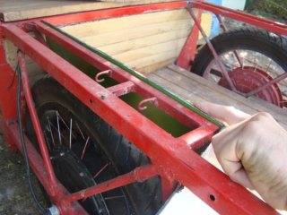

Today I got a few small things done on the trike:
--replaced the missing two short boards on the rear right corner of the bed. Not sure how, but they came off (or someone took them), a little while back.

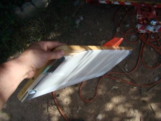

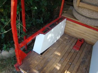

--added a thick reinforcing backing to the tailgate, using some 1/4" thick "foamed" plastic off an old retail display. This way it's unlikely that anything that ends up loose in the cargo bed would break the 1/16" (or less) styrene that makes up the "chalkboard". It could still knock the tailgate off if it exceeds the magnet strength, but that's unlikely too, since if I was carrying anything like that I'd strap around the side boards and the tailgate, or strap the cargo down. :)
--added inboard fender covers to the fender frames, so stuff can't hit the wheels (including doggie tails and paws, once I enclose the rest of the rear end with the wooden frames).
I considered several materials, first wood but that would take too much space. Then thin sheet metal, cut from old retail shelving, but it's heavy and it would be "boomy", making the doggie compartment loud, even if I welded it to the frame. Instead, I went with a composite material off that same retail display, thin aluminum sheets bonded to a foamed plastic core, cuz it's stiff enough to not boom/rattle, and light and thin as well as tougher than just plastic would be. I wish I had a lot more of this stuff, cuz I can imagine a lot of uses for it. I pop-riveted it to the frame; was gonna use rivnuts at first (so I could remove them for access to the wheels from inside the bed), but I couldn't find any screws/bolts that were short enough, with flat/bevelled heads (so they don't catch on doggie fur or cargo), so went with regular rivets for now (can always change it later).
To wrap it around the back end, I didn't ctu all the way thru, just partway so it would "fold" around the corner of the frame.

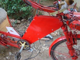

I intend to use the same basic method, but using rivnuts, to cover up the "front triangle" that has the wiring in it--but this will be metal covered with wood, or just wood glued into something like the seatbox is made with, but secured to metal straps that the bolts going into the rivnuts would actually hold down. Or maybe just recessed holes in the wood for the bolts and some washers. Not sure yet, have to build the wood stuff first and see from there where I go.
That's about all I actually finished today, but I also borrowed some chalk from Raine so I could start sketching the dog heads on the "chalkboards", so I can then use some glow-in-the-dark and/or white paint to permanently outline them on the side and rear signs.
Now I just have to decide exactly how to sketch them, and who goes where.
I was going to sketch Tiny and Yogi as the main two in teh big space to the right of "S.B.Cruiser" but after running across this picture (while trying to get just the right angle for reference), I may just do Tiny in that pose in the big area on one side,
and Yogi in one of his cute poses on the other side, like maybe this one
and Teddy in one of hers on the rear--probalby the one with the goggles. Then the others, including Kirin, and those I lost in the fire, will be smaller heads/etc under the "S.B.Cruiser" part.
I'm not a very good artist so I don't expect this to look very good. I might do what Raine suggested, which is to print out a "line art" version of the reference pictures onto thicker paper that's then sprayglued to card stock or plastic, and used as a template/stencil.
We'll see how it turns out, I guess.

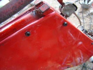

With limited time, I decided to simplify the front triangle wiring covers, and just use more of that 1/4" thick "foamed" plastic.
The right side is riveted directly to the frame, as that has the chainrings on that side, and would be harder to work on stuff in there anyway.
The left side uses rivnuts in the frame (which are damned hard to install),
with teh plastic cover bolted to the frame.
To be able to take the cover off completely, I'd have to either cut a slot in the cover, or take the pedal off the crank (Easy enough with a wrench I have with me in my toolkit anyway), but I would usualy only need to take off the bolts, and then slide the cover down the crank and lean it on the pedal. Then I can access any of the wiring in the frame area there, which hopefully won't be needed except at upgrades. :)
I havent' needed to access it since the rewiring, so I could probably have just popriveted the left side on, too...but if I did need to access it at roadside, that would have been annoying to have to get off of there.
While I was at it, I popriveted the main cutoff switch and the XLR charging port into place, but I swapped their positions since my toes sometimes hit the switch housing when I get on or off the trike. It's not much more clearance, but it's enough.
I need to make a bracket to rivet to the frame that will let me mount the lighting switches to it.
While I had the cranks off to install the side covers, I swapped them out for some non-ovoid regular 28/38/48 rings (also 170mm cranks),
because while the Shimano BioPace stuff works great on a regular bike at the angle the cranks are at to my legs/body, they actually make it harder to pedal at the angle everything is at on the trike. I'd need to rotate the ovoid part around something like 30-40 degrees (at a guess) to get the same effect as I'd have on a regular bike.
The round cranks let me pedal it quite a bit easier, even with the same tooth counts. I could also take the derailer (used as a tensioner only) off the IGH input, if I didn't want to be able to change the front gears (by hand, no derailer).
