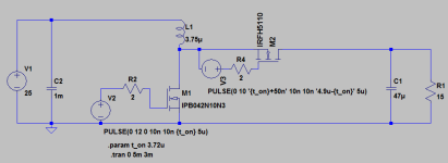

So I came up with the idea of using a step up converter which converts the 25V from the batteries to 25 to 100 volts for the controller. A viable design would be a boost converter with a synchronous rectifier; I have simulated one in LTSpice:
Once I already made such a converter, but this is only a small one with 20 watts of output power and it is about 92 percent efficient.
To increase power, I would use three converters in parallel. The switching points of the MOSFETs will be apart by a third of a period; this will vastly decrease input and output current ripple compared to one single large boost converter:
There are some ATmel microcontrollers (for example ATTiny261) which would be very suitable to control the six FETs.
The output load is modelled by a resistor. In the simulation the 3 phase converter delivers 2181W and draws 2263W from the battery; this would mean a 96.3% efficiency in the worst case scenario of 100V output voltage. So the general statement "Don't use a boost converter, it is inefficient" doesn't seem to be true. The part costs should be about €25 for the power parts (FETs and inductors) plus maybe €15 for the controlling parts. I would build it on an aluminium core PCB and mount it in a heat-sinking case, together with the controller.
