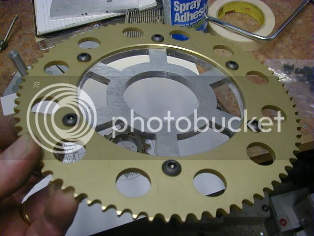

Tonight I motivated to adapt my e-bay 219 sprocket to the BMXer.

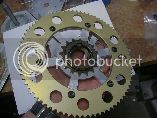

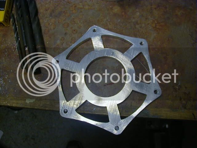

So I thought I would try this part by hand & see how close I can get cutting to a few lines by hand.
I hope a lot more guys will attemp to make some parts once they see how easy it is to do with simple hand tools.

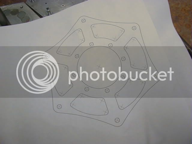

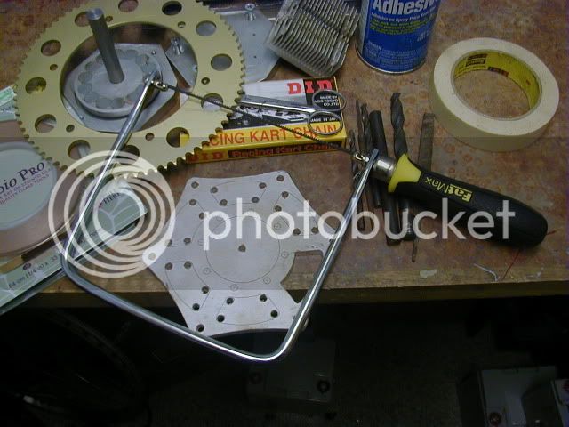

I will start out cheating & use a print I already had drawn in cad. I should have redwawn it with my pencils & compas.
first make a drawing at full scale.
then I glue the paper to the stock aluminum. (I get the majority of my metal at local scrap metal yards)
I cheated again & went to the 9" ryobi band saw I bought as a floor model for $25. It is the cheapest plastic framed wood working tool I own (it is in the room used to build my balsa air frames with)
its just 1/4"t aluminum plate. total time from start to this point. 1 hr 45 minutes
(not really done as i havn't mounted it to the freewheel yet)
I drilled the access holes for the copeing saw
cut the shapes
filed the rough cuts to the lines
Made the finish size in the center with 80g sand paper on a 2"dia dowel to get a close fit on a freewheel
I did drill some holes much closer to the lines than in the photo.
upon very close inspection you can see the hand cut edges compaird to the machined edges on the sprocket.
After all was aligned & tightend down it is .015" out of concentric.There is more play than that in the mounting holes. so I could prolly get closer if I though it needed it.
Here is the tool list I used;
band saw (optional)
coping saw
3/8" drill motor #7 drill bit
1/4-20 tap
1/2 round mill file
flat bastard file
sandpaper/sanding block
I guess you need to be able to draw so I wil say paper & pencil & a compas & a litlle geometry & you dont really need a computer or printer. or even elctricity.

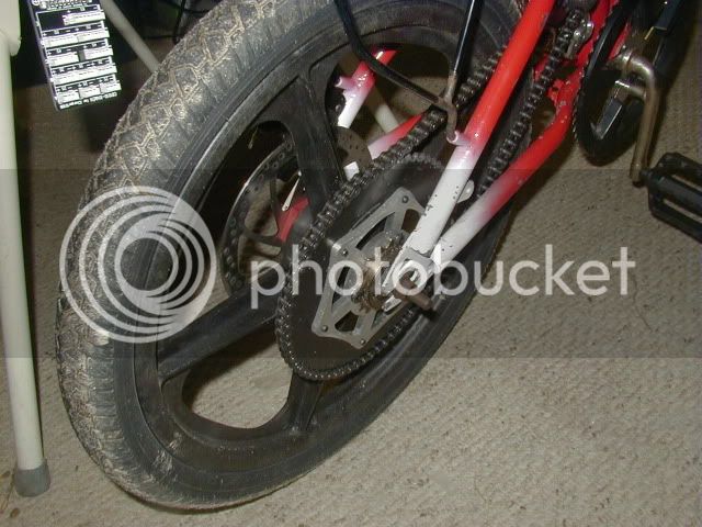

well I had big plans today for e-biking. some days are better than other I suppose.
I anealed my 219 dive sprocket so i could bore the taper out of it & fit it to the tranny to match the new freewheeling driven sprocket set up. turns out my 114 link chain is about 8 lincks too short. :evil:
soooo I draw up a template & attempted to repair the miscut #35 driven sprocket & bore it to fit the new freewheel adapter. this takes most of the morning. I finaly get every thing put back together & go & get my grins.
I am really pleased with the performance the only issue is Ive geared down the final drive & i can make the primary skip a few teeth when I really jam on it. it wheelies at will & i removed the pedal chain as it will not fit with the freewheel sprocket adapter. I am all -electric on this build for now. I attempted some one handed video....you guys really don't whant to see that farce. I will try to figure something out,maybe have the wife film my fat self wheeling up & down the driveway. Here is a screenshot of the logging software from the ice.

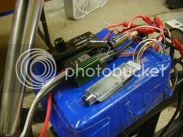

I did have a failure today also. My 380kv motor had one of the phase wired work into the relief groove & cut itself in 2 pcs neatly on the edge of the can. Now I have my outrunner to re wind LOL. I put one of the 270kv motors on it. seems almost as fast on top end but can't really judge as I was getting to the end of pack charge. I had my 1st sync issues also with the 270 motor. if I shift to early I can make it lose sync under heavy loading. But starting from a stop is no issue. To much throtle just lifts the front wheel. one video & this thread is done!

Thud,
From the picture of your ESC, it looks like you soldered the two caps together and then took one set of cap leads to the positive and ground. I did something similar and burned the positive cap lead in two when I was lugging my bike up a short steep hill. Each cap needs to have its leads going directly to the pos and neg.
Bubba
Thanks Buba, I will make the changes.

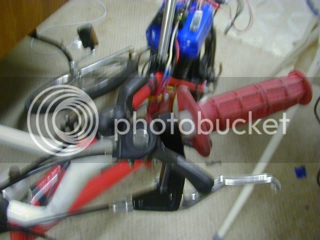

funny you should mention that.....I just tore the handle bars off to re confgure this brute into a road racer :twisted: :twisted:
I am also going to streatch the frame a bit this weekend & slap in a 2500watt motor & bump it to 48v.....hopefully I will have some footage of me knee draging a parking lot sunday night.........& then prep it for a possible trip to Tuscon for luke (or dogman) to race in the spooky tooth deathrace 2010!

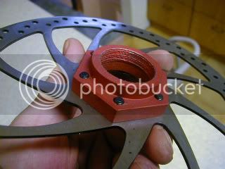

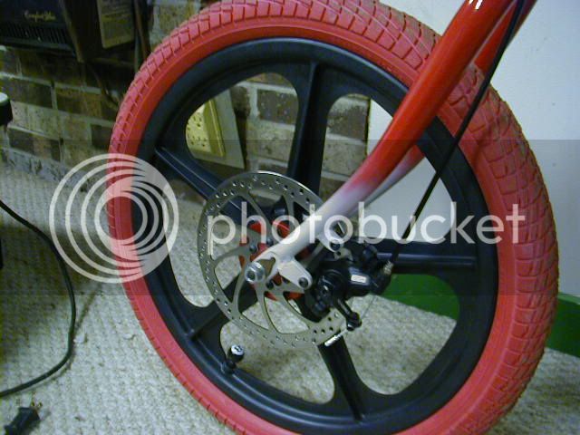

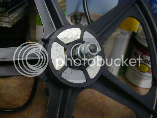

Hello RWP,

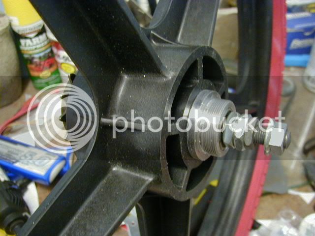

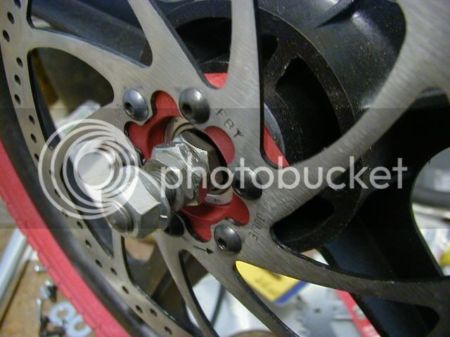

The skyway wheels have lots of room to allow the brakes so I cut some alumn chuncks to fit the molded interior section around the hub & then made some spacers to hold them to the correct width...then the whole assembly is bolted on the ends with caps that are bored to accept the discs.
The rear wheel was even easyer as it is just threaded disc adapter on a flip flop hub.
the flip flop hub
rear disc adapter
the front wheel shims to keep the disc form rotating & spread the braking loads
And all assembled.
Did you make the threaded disc adapter, or can I get it someplace?

The adapter is a one off- but a simple fabrication...the disc bolt circle is 44mm & the internal is a somewhat standard 30x1 mm thread (small BMX). I sorta fudged it as & don't have a proper pick gear to do a 1mm thread. it becomes a Jam fit for the last 1/8 turn onto the hub.
Here is a better pic of the rear adaper:

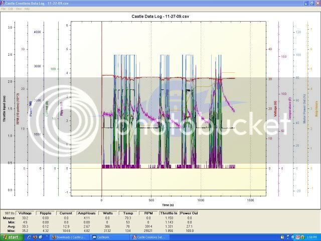

No problem bringing up controllers. All of my work is focused on the big outrunner's....& using the existing magnets to trigger the hall sensors.
I bought a batch of 12fet infineons from the e-crazy man awhile back just for side by side testing & have been giving myself some lessons (learning by watching over the shoulders Of Mr Harris & Ricky in NZ) on controller assembly & operating. I am getting good results using irfb3066 fet's in them after making the R43 Mod to side step the over current interupt circut. The only issue is, I am limited to 60v Max......I have bugeted for some irfb3077's to push back up to 72v if i think i need it...These are like thoses mr Lyen provides....Just without all of Edwards fine work in them.
Hall sensors on outrunners:
Using Burties size optomised 17.14deg spacing has been good & bad...on the smaller 63mm motor, it seem's to perform perfectly....I can reset the zero position in several spots about the can, & adjust the timeing up & down & get the predicted results...powers the bmxer fine with a modded 6fet (4110's in it) @ 48v other than being current limited...it just works.
The Casle hv160 pulls a bit stronger through to top speed,(quite a bit actually) But under max (really stupid max) load I can hit the current limit. Then weird things happen. 50% of the time the motor will revers...(???) After freewheeling to a stop I have to unplug to reset the controller to get rolling again.
The mid throllte/RC controller issue is: Unbelivablely high current spikes generated when the controllers are chopping the current (pwm)...under heavy load & partial throtle (flyback effect?) the FET's don't have the theramal disapational ability to survive. This is compounded by the small size & Fet package in RC controllers.(I'll not scare any one with a photo of an exploded controller :twisted: )
I won't say you can't build a nice reliable RC set up....You Can....I am saying that I can't trust a singe hv160 to perform reliably within my objective.
