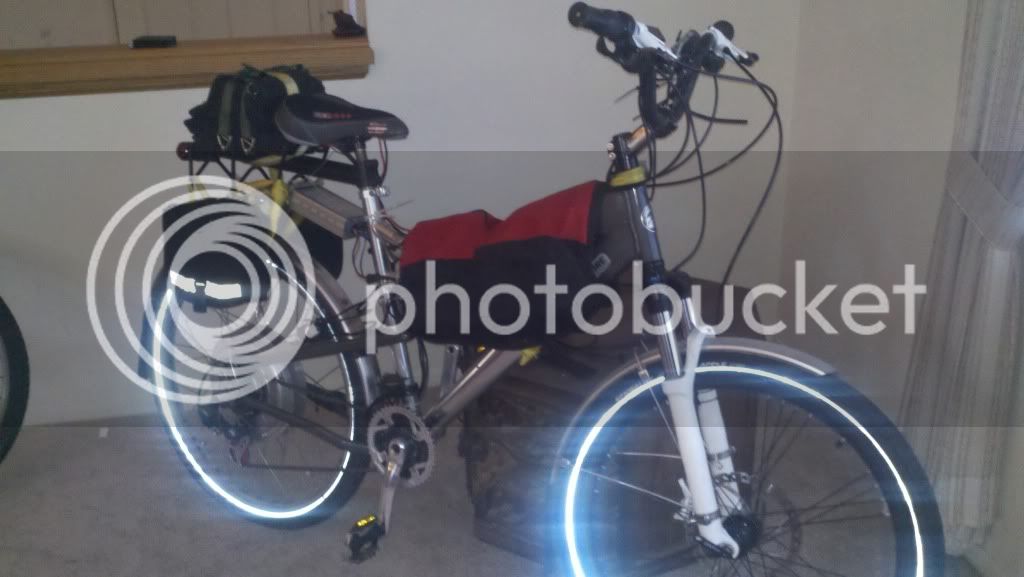

nice work! where did you get that threadless stem extension? i've been looking for a way to raise my bars about 2"
I got the bike off Craigslist with the extender but I believe I saw them at my local REI store. Hope that helps.

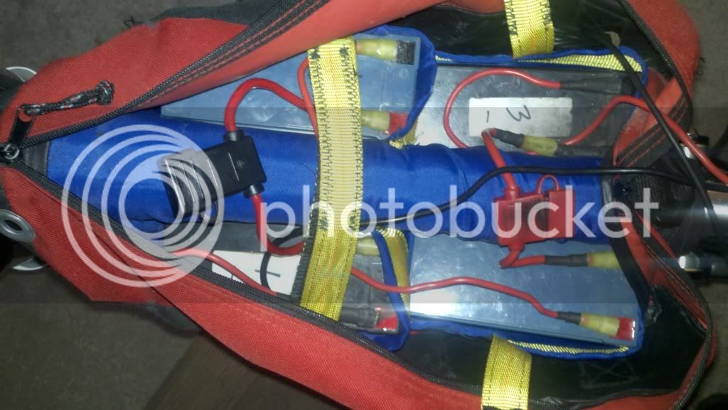

There 18s2p lipo stuffed into the battery box, and the motor is the hs3540 although i really wish i went the HT instead.
Since the 'after' i have made much larger cooling holes in the motor, and a vent/window in the battery box.
Just sorting photos to make a build thread so keep your eye out :)

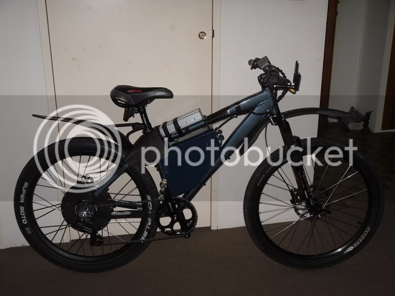

Just thought I would post this up.. I have just finished it for my son-in-law :D
Its not fast but it is fun :mrgreen:

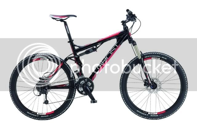

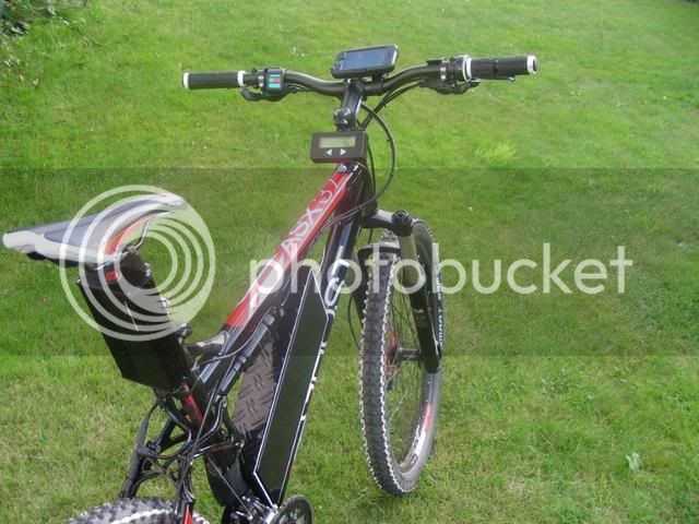

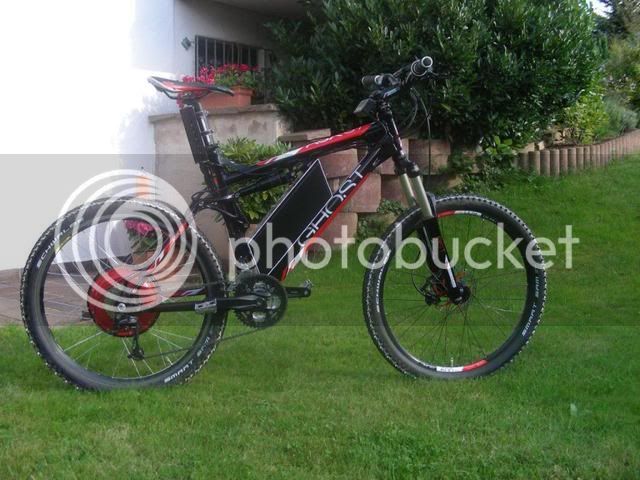

Here is my bike.
Raleigh mountain bike with MAC 500W rear motor and Ping 48v 15Ah pack.
I made the fibreglass panels to hide all the workings. The charge port and on/off key are mounted on the left hand site in a recessed panel.
