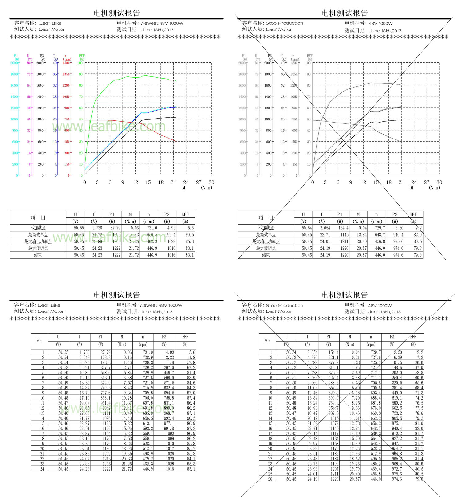

Stated efficiency seems to vary per vendor.. from a maximum of 80% to a maximum of 90%.
Leaf motor makes a claim about this motor as having higher grade laminations. I suspect this could mean ~0.33mm laminations, which would somewhat explain the high efficiency claim of these motors. They make a claim of difference in efficiency for their newer 1000W motor as well. So, i figure this may be legit
Here is the data on their new motor.

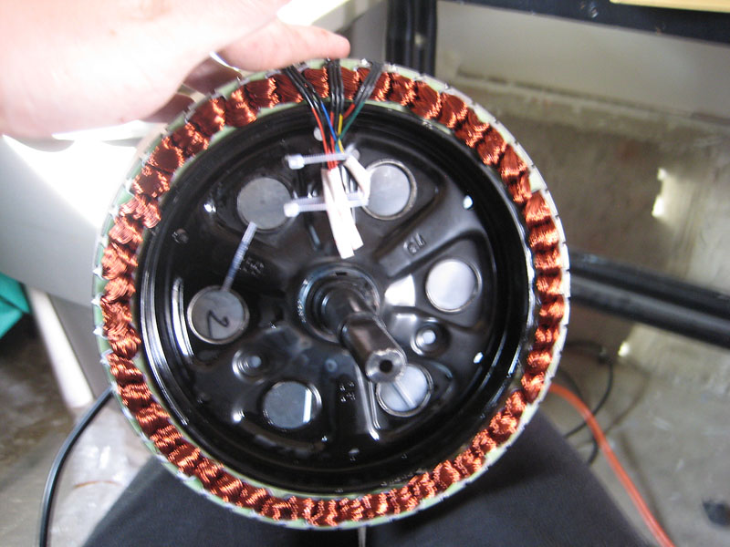

I just got the leafmotor 1500w model in the mail today and pulled it apart just now.. 0.35mm laminations, very tight windings ( way better than the 9c/crystalytes i've seen, 35mm wide stator, and it fits into a 135mm dropout. VERY IMPRESSED.. all signs point to this motor being more powerful than the crystalyte 35xx series and magic pie. More pics and data later!

I can summarize that graph for you...
That motor is horrible. 77% peak efficiency is awful; the worst i have seen for a direct drive motor. 1500w peak power is not a nominal rating. It's more like a 1200w (or less) motor. Do not buy.

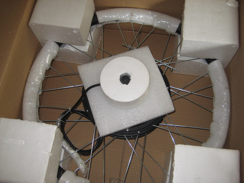

Pretty standard packing job
I asked for a 24mm internally wide rim, and they certainly delivered.. spokes look like 12-11 gauge.
Axle is about 8.5 inches or 215mm wide.
Are you serious... these phase wires are more for a 500w motor... :(
Came with 2 extra spokes and some fuses, etc. Nice touch.
I had to know... are these laminations actually 0.35mm or not.. :)
Nice stator construction.. windings are also fairly flattened.
Within a rounding error of being 35mm wide.. okay!
Yup, 0.35mm laminations it seems.. :)
I couldn't get a really accurate measure here, but it appeared as if the magnets were just a tiny bit wider than the stator.
There is a bit of a gap in the magnets..
Stator pic.
Phase wires look like 18 gauge.. this needs to be remedied... very inadequate for the rating of the motor ( and the hell i plan on putting it through )

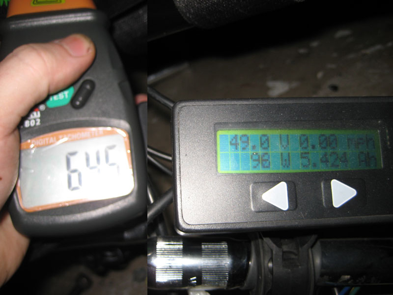

645rpm / 49v = 13.16kv and about 95W no load. The wheel was bouncing up and down a lot due to the wheel being out of true ( typical china build ), so the real no load might be more like 90w. This is impressive for a 35mm wide motor, actually. My memory is fuzzy, but i remember my MAC 8T no-loading at ~150W and the Crystalyte HS3548 no-loading at a similar wattage.
I feel good about this motor, though the wheel build is hilariously off.. so i've sent it to the local bike shop to get trued.
