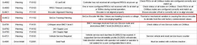

6). Check sine and cosine peak and trough voltages:
- Peak voltages should not exceed 4.5 Volts.
- Trough voltages should not descend below 500 mV.
- Peak to trough swing on sine and cosine should exceed 1.0 Volts.

2) In order to be able to read the Ud and Uq values accurately, you need to turn the electric motor externally (using a power drill for example, or the vehicle’s own inertia). If possible to use some external power to turn the motor, then you can start a trace as explained above and collect the information (use the “Stop trace” button – looks more like a pause button). If that is not possible, then you can drive the motor using our Gen4 controller and when reaching full speed, select neutral or remove motoring torque to the Gen4 controller and start a trace as the motor starts to decelerate. Note: You must have 0 neutral braking set and the bridge still enabled to successfully trace this,
3) Once the trace was stopped (it is automatically saved in the “C:\C6944\DVT\veh_if_log” folder), you can use the built in utility (“PMAC Encoder” button on the main page of the DVT Helper) to look at the offset angle.
4) Click on the “Graph Voltage Vectors” button in the “PMAC Encoder Alignment” window and you will be prompted to select the trace file you collected in the previous steps. Once you select the appropriate file, you will see a new window that shows the encoder alignment. In the screen capture above, the encoder is slightly misaligned (you see the graph points form a bar tilted slightly to the left of the Y axis). To correct the encoder alignment, pick a point in the middle of that bar made of multiple points and click the mouse on it). You will see an alignment value display in the textbox below the graph. Press the “Subtract Calculated Angle from Offset” button to commit the new alignment value to the Gen4 controller.
5) Recycle power to the Gen4 controller key switch and repeat the test to verify that the encoder is properly aligned. If the motor is spinning in the forward direction, a well aligned encoder will produce a bar that is positive and along the Y axis in the graph above.
