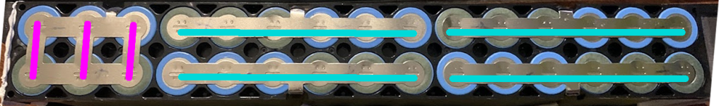

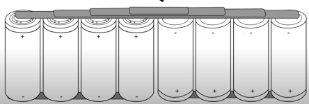

I'm in the planning / designing process of building a 10s3p 18650 battery, or a 10s2p 21700, that decision isn't made yet. The max amps that will be pulled from this pack, will be 15A, so not a lot. (300W motor, with 540W peak)
Online you can find multiple sellers, using small 7mm wide strips but I'm reading a lot about the amp draw between the p-packs, so my idea was to buy a 30mm wide, 0.15mm thick nickel strip and cut it to size to fit my battery design.
I allready saw the table on this forum, with the thickness a width of the most popular nickel strips, but it stops at 10mm. Is it as simpel as multiplying these values?
a 5mm strip can handle 3.1amps, a 10mm strip can handle 6 amps, so I assume that a 30mm strip should be able to handle 18amps? Or doesn't it work like that?
Here is the idea of how I want to make it
Thanks!
