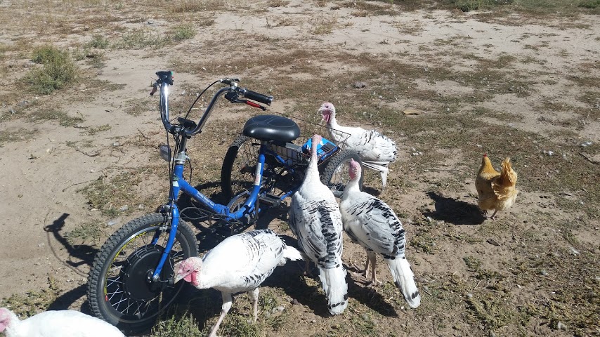

48v 1,000 watts front hub on 20" wheel Workman trike. BMX tires. 6 months new.
Used around the property. The tire would occasionally spin in the sand resulting in a blown circuit breaker. Eventually getting worst to the point simply turning it on blew the circuit. Now it just won't turn on at all. Changing out the the breaker makes no difference. My thoughts are that the controller couldn't handle the amperage drawn when in sandy situations and failed.
Am I correct in my assumptions? Would a higher wattage controller possibly be the answer to my problem?
Thanks in advance.
I'd say higher amperage, to keep the same voltage then drives up the watts. But I don't know how high it would need to go, I guess you're talking some serious surge. You should figure out if the controller really is what's dead instead of assuming.

What is this circuit breaker? is it the battery management system shutting off on the battery? If so, your problem is entirely the battery.
You will be pulling a lot of power with that motor dug into sand. I have overheated motors that way faster than any other way, riding in deep sand.

I don't get why the circuit breaker would pop if your battery is weak. ( I mean now,, with the wheel on pavement) I think it's the bms inside the battery popping. The boost the charger gives making it work again sort of proves something. It could be as simple as a bad connection,, like that circuit breaker is cooked. or a plug. I'd try bypassing it all with some new wire, like jumping it past all the battery plugs and the breaker, see if that helps. Before jumping to the conclusion its the battery. But you did change the breaker,, it did not help,, that's not a good sign.
Then, look hard at your battery. test the voltage at each cell group, see if its got a weak cell group, or just unbalanced, etc. Just unbalanced would make your bms trip very easily because voltage on that low charged cell group is sagging under load. As for when the breaker pops,, that proves how hard that sand is working your battery. HUGE amps surge to get going in sand.

Problem 1: I'm only reading a charger output of around 20 some volts DC at the peak. On it's AC setting the voltmeter reads a steady 24 volts. It's displaying a green light showing a fully charged battery. The battery is holding 43 volts DC.

New charger isn't doing it. Reading the literature that came with it, apparently I can't check the charger output accurately. I probably got the wrong reading off my old charger when I thought it was bad. Reading low voltage on the battery itself, everything else seems to be fine.
I just paid $500 for this battery. I really don't want to buy another. Can this one be rebuilt? Never had this trouble with lead/acid.
