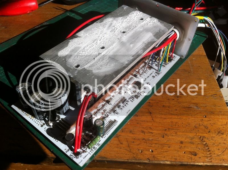

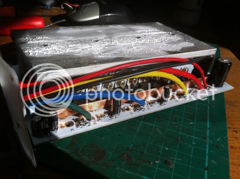

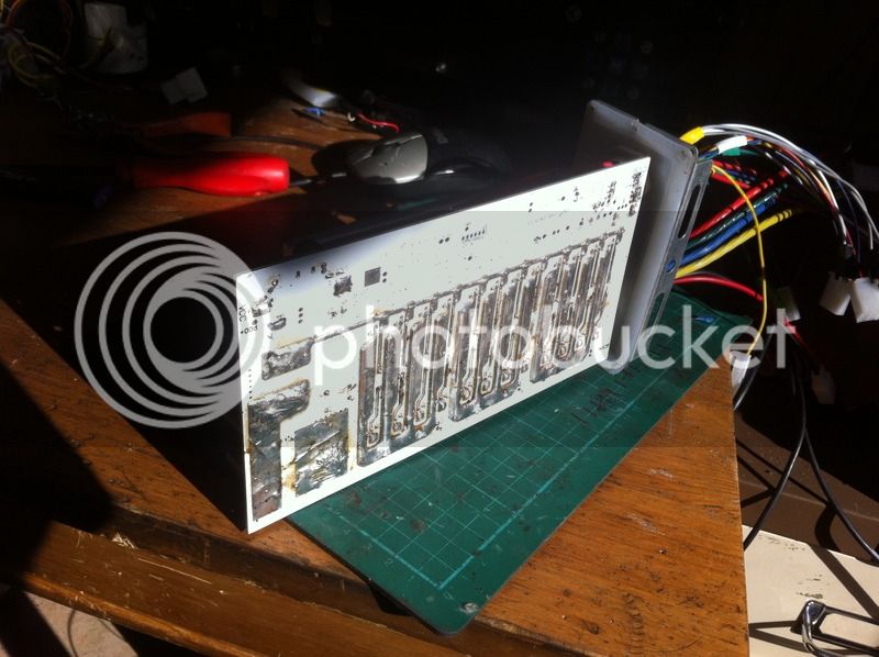

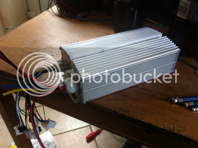

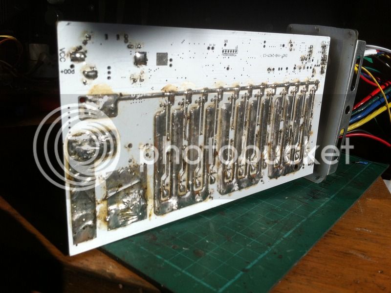

Well, after the seller told me it was the 15-fet version I cancelled my order and shortly got my money back. I went on vacation last week and when I got back noticed I had a package in my sunroom. What do you know, it was mailed anyway! lol It has the exact same internals as OP's 72v 500w version.
Here's some pics

2000w 80v
board= eno-yhb-24cm-13
caps= 100v 470uf x9
fetsx24= RU1H150R ? only info i could find, vds-108 / ID(A)150 / RDS 3.5v / VGS-20 / PD(W)-288
same board http://www.ddc.net.cn/offerlist/1031130/500957.html
