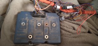

if I can find one of the larger sevcons somewhere
If it helps, I have a sevcon Gen4 80v 350A and the main connector with some wiring harness on it. I do not know it's functional state, it was sent to me along with some other parts; I think from one Zero bike or another, but don't know which one--some marker on the heatsink says "15fx" which if that's a 2015 ZeroFX means it should be setup for a ZF5-7 motor?
I'll never be able to use it because I can't program it (don't have the hardware or software or expertise, or the money for any of those) (and it is totally overkill for anything I can ever see myself needing).
If you want to try it out, then if you'll pay for whatever shipping would be from Phoenix AZ 85051 (guessing around 7-8lbs, size of a big thick hardcover book), I can send it to you, then if it does what you want you can donate whatever you feel like to my projects or dog (well, JellyBean doesn't really qualify as a dog, just an alien Schmoo). If it doesn't, then just forward it on to the next person that wants to mess with it.

At least one other zero here has posts about alltrax problems; I think it was a throttle thing but was a while back.
Yep its most likely from a 2015 fx, which ran with a zf75-5. Sadly though, Ill have to decline your offer for now since Im still not a 100% sure what motor Ill end up going with. If I do find a zf75-5 somewhere Ill reconsider but without a way to reprogram it for regen :/ Again though, thank you a lot for your offer!

I think Ive seen that thread a while ago...Ive also had another alltrax die on me after sitting for about ~10 years, it was an axe4834 I believe, its just completely dead, no error codes, no lights, no nothing, Ive also got another one sitting in a 2010 zero s which Im hoping is functional but I dont have particularly high hopes...
a controller that just dies sitting ther eproblaby has bad capacitors. they are chemically operated inside so they have a limited lifespan. some are made poortly so they go bad far soon er than tehy should. happens a lot in power supplies, which is basically what controllers are inside.
it's likely i'll have the sevcon around for the foresceeeable future so if you end up needing to try it out, it'll probalby bve here. or if you know anyone else that wants to try it.
if i knew it's condition and programming setup i could just sell it (cuz they';re apparently worht quite a bit) but not knowing that i wouldn't feel very good if it ended up being a deader or soemthing... given who it came from i expect it probably workse perfectly and is still setup exactly as it had been for the bike it probably came from, but i can't know without testing, wich i don't ahve the motor or other bike hardware to do. :/

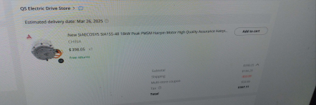

I also made an impulse purchase and am now expecting a sia155 48 at my door in a week or two, got ~15% off because of the aliexpress sale (and having spent over a thousand dollars in one order 🫠)!
Shouldnt be quite as powerful as a 75-7r and it is not much cheaper but it should be a lot easier to mount which is a major benefit as I dont have the equipment to weld aluminum...
