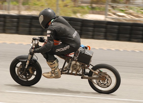

If you use the smaller motor, you could put together something similar to the pic below (Luke, on his "deathbike"). I like to call that style a left-side-drive. #415H chain and sprockets would be the lightest I'd attempt to use, and #428 would definitely be strong enough. What controller would you use? Perhaps a Lyen 18-FET using 18S LiPo (65V-74V, 3.6V per cell when low, 4.1V when charged) just for a start?
You haven't mentioned the tools and experience you have, or your budget. Going fast takes a lot of money.
