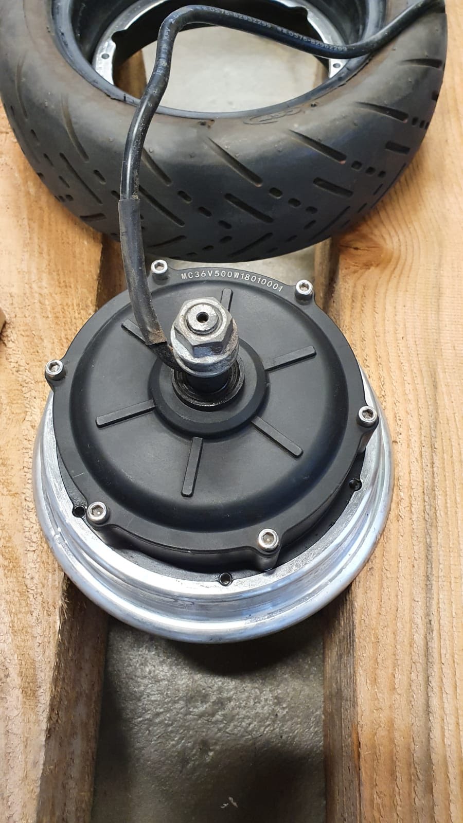

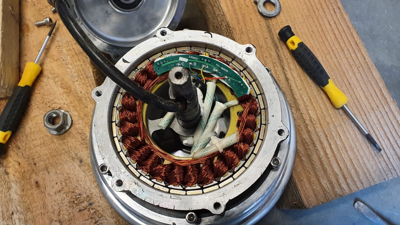

I've just dismantled the 36V engine from my e-scooter.
Some wires are burned, they have been short circuit because of wire damage, so I wanted to replace those wires anyhow before using it again.
Here the escooter and engine.
From an expert opinion, is it worth the effort to upgrade this motor?
If so, what can I do to upgrade it?
