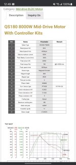

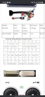

Ok so after talking to a rep the nd72580 won't work with the qs180 as the motor is a encoder, an that controller is for hall.
Also I found this info for the motor I'll be purchasing.
It shows the amps. This motot works with 72v by the way. There's not alot of room for huge car batteries. That's why I'm looking at the amorge battery. Here's a list, what you think on those setups?

The batteries are 14v each so you would need multiple in series to reach 72v nominal voltage. Wiring batteries in series combines their voltage, wiring them in parallel combines their amps. I have a tiny converted CL175 with a 72v80ah battery and I get around 60ish miles of range going 45ish on average, so you'll probably want more than 50ah. Good luck with the build!
Why do I need a series of 14v to reach a 72v? Why can't I just buy a 72v50-80ah battery with Samsung cells with 300-400 bms current, with a peak of 420 to 560amps?
Id think that would be perfect as it's a battery that supports up to almost 40k watts. Volts x amps
Then with the controller 500a with peak of 1000a so it should carry that little 3 wheeler quite well in takeoff an performance for what I want. The controller I'm looking at is recommended for lightweight electric vehicles. This thing is NOT heavy lol For some reason some of you guys think I'm trying to power a car. Lol
