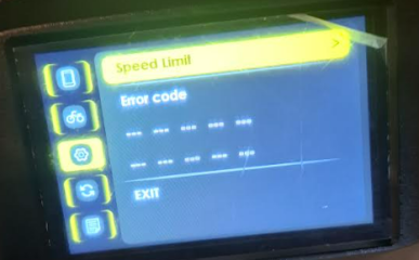

750c only lets me access speed limit in advanced settings
Big Dog
🧲 New user
Nov 6, 2025
12
Australia
I had access to current limit poles etc when it i got it and ran the motor. When I installed it it came up with Error 08 and the Error 30. I reset defaults and now it comes up with dotted lines. This is a retrofit and have disconnected controller cable and motor cable (came up with a hall sensor error which it should) but no difference and PAS doesn't work but throttle does. Lost here if anyone can help thanks.
The only difference was connecting PAS sensor. I think by restoring defaults it stopped talking to the controller and needs to be programmed. I'll be sending it back thanks for helping.
