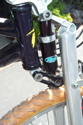

Dear All
Your precious comments on the base of technical point of view will highly be appreciated. It just came to my mind while i was half a sleep and woke up and draw it in Pain. It seemes simple but efficient for off road conditions. it could also modified for tuning for stiff or lose for different weight conditions. Before going to try i thought may be i could get some feedback from tallented people on this website.

Some early mtbs were setup something like that. There was even a guy who built motorcycle front ends like that for off-road bikes.
Hi Naeem,
Do a search on "Girder forks". It was one of the earliest forms of front suspension for motorbikes.
Amp Research revived the idea for mountain bikes in the 90's.
Here's a modern version: http://www.german-a.de/kilo.html

Of the four examples I've posted here, yours most closely resembles the Girvin fork. I can't figure out what the third linkage on top of yours is for, though.
Chalo
I think this is a good way to go for a DIY system, Naeem.
Unless I've misread your drawing, you'll need to sort out what moves around the steering axis and what doesn't, though :wink:

If I read that correct, his suspension is ridgid to the frame, and that top part you mentioned is steering linkage.
I Think I've seen a Hodaka with something similar, though I can't find a picture right now. I know BMW was using long, unequil leingth A Arm suspensions on a couple of bikes.
I've riden one of those AMP bikes. Its buttery smooth, but heavy. They also didn't have much travel.
EDIT (to add how it looks like it works to me): There are two headtubes, and two steerer tubes. The linkage bars are attached at pivot points to the headtubes, presumably just inside the bearing races so they dont' interfere with turning. The steerer tubes would be connected just like remote steering on many recumbents (including my CrazyBike2), which is what that third linkage on top is for. Turning the handlebars on the rear steerer tube pushes against the linkage which pushes against the front steerer tube's pivot point which turns the front wheel.
ORIGINAL:
The only potentially big issue I see with it is that all of the torsional loads of frame twisting are now no longer carried by the strong headtube-to-top&downtube welds, but instead are carried by the eight joints pinning the four linkage bars between the two headtubes. That's a lot of force to carry at such a tiny point.
If the points are beefed up then you need thick and/or strong metal for those linkage bars, so they themselves can't twist.
Otherwise you risk the front fork swaying side to side (not in steering) as you ride over a varying-angle surface, or pulling to the left in a righthand turn, and vice-versa.
It does look like a nice idea, but you may need to do it with dual-tubes on either side of the actual pivot as some of the photos show, rather than the much simpler method you have in the drawing (which I like, but am not sure it will hold up).
