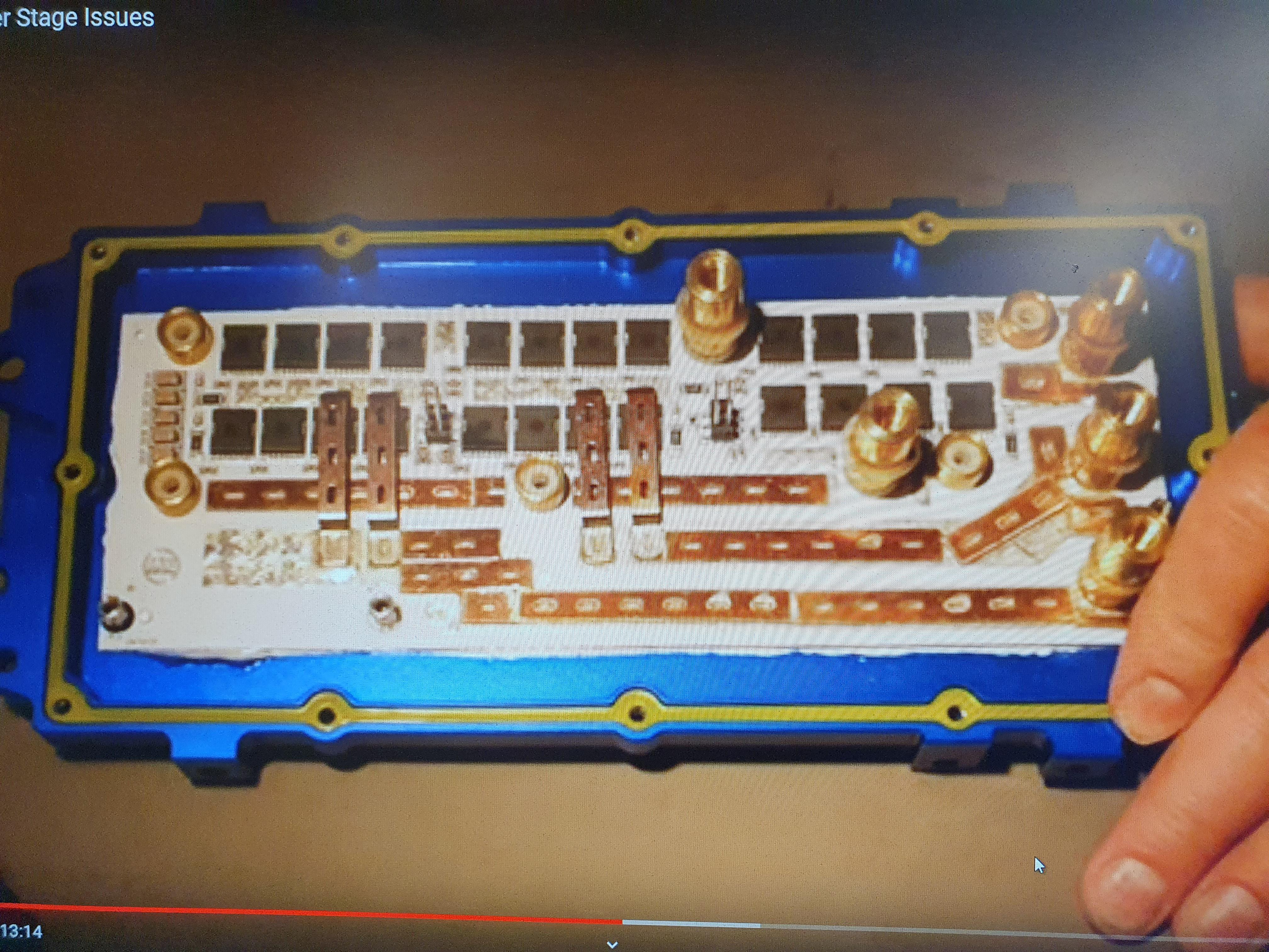

There seem to be some sort of beef between them and another company, and some guy has opened up a supposedly hi performance controller from this KO company.
The guy thinks it is crap, and I must agree it certainly looks like he has a (or a few) point.
Especially looking at the powerstage.
A little from his post with some of his youtube videos, I dont know if I can link to the facebook post :(
What do you more electronics knowledgeable guys think?

The controller doesn't look too bad to me for an ebike controller. Less refined than an ASI, but above average design.

Really? I thought the current passages looks quite horrible with gaps and no copper in some places on a controller that is supposed to do 800pA.
I would have liked to see the underside of the pcb also though, I think the current passages from the mosfets might be on the underside too?

A picture from one of the youtube films:
Those loops from the copper traces seem to only connect to pcb traces between the fets with some extra solder.
I suppose there are copper on the underside, so that might not be a problem.
But still, 800pA on this design?
It's tough to say how thick those copper bars are. I'm hoping they are 3+mm thickness and say 10-12mm width (between each parallel pair). If it's ~33mm^2 will heat at 800amps from 50degC to 100degC in 14seconds assuming no cooling.
In my experience with an 830Amp Sur Ron, it's very difficult to use the full phase current for more than say 5-6seconds at a time, because it's already reached top speed by then.
Lots of folks here are putting >100Amp phase current through 14awg phase leads. This would be the same current density as 1550Amps through a 33mm^2 bus bar. Certainly not stable for a continous duty cycle, but works fine for bursts of acceleration.
Also remember, it doesn't need random copper everywhere, it only needs it where current density is highest. One side of that controller has low current density as its power path comes from a single side to the FETs.
It's a horrible layout, not optimised for thermal, for switching or for current carrying capacity. I watched some of the KO "no hype just facts" nonsense video, the guy making the videos has no clue.
You can get 800A from that many TOLL FETs, just, but not continuous (few seconds) and it's anyone's guess how hot the jumper bar things get.
The KO motor does look like a serious upgrade over the stock surron or qs motor though. Wider rotor and a nice flux path optimised for MTPA. Probably generates a fair bit more torque.
Edit after LFPs post... The way the copper bars have been folded, there's no way they're 3mm. TOLL is 10mm wide, they're narrower than that and have lumps taken out the middle (again not likely possible on 3mm...) So I'd estimate more like 1-1.5mm with 10mm total width (5mm/jumper) so 10 to 15mm².
Then there's the single strips across the board. So like 7.5mm² but cooled by the IMS sinking the heat.
