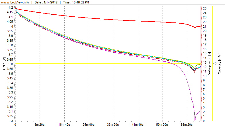

like i say in my battery tutorial for series charging.. a cycle graph will tell you more about a battery than anything else. Do you have a nicer RC charger that can plot out a charge/discharge graph for you?

By the way, this is what an A+ grade pack looks like on a cycle graph. Before the first cell hits 3.0v, our cells are hitting 3.0v at nearly the same time. This means the cells have very close to the same AH in them, and if we cut off as low as 3.5v nominal, we've got all kinds of fluff room to ride this pack without a BMS.
What you don't want to see is something like this.
^-- one cell is missing capacity
And Definetely not like this.. :lol:
^-- IR of cells is all over the place. This 'new lipo pack' turned out to be made of recycled cells of various vintages. Even the pitiful 0.1C load placed on the pack produced wild voltages due to the massive difference in IR between the cells. China selling you back your trash..
