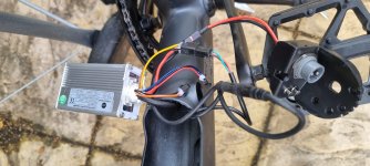

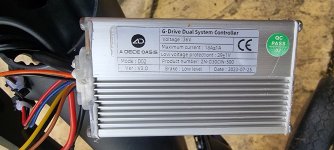

I opened the bike stem to have a look at the controller. It's a different controller. Very neat and I suspet that speed control and other functions are all managed in the item's firmware. The controller display is the S830 which has a USB socket, very good for keeping the phone charged on long rides.
The yellow and brown cables take the input fromthe Hall sensor. The black connector on the right passes through the stem to the display unit. The red and black cables are the power input from the battery. There is a thick black cable which connects to the motor. There are two other cables sets with connectors which are unused.
The controller model number is ZN-DC30CIN-500. I've not found any reference to it in a Google search yet...
