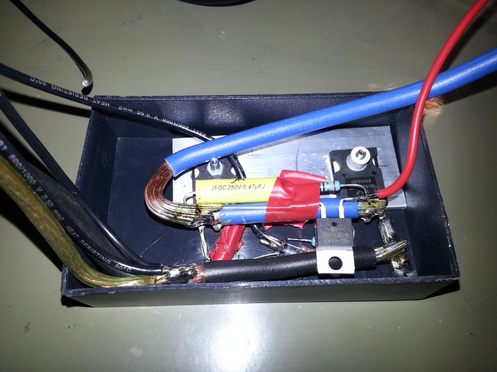

This will be the main switch

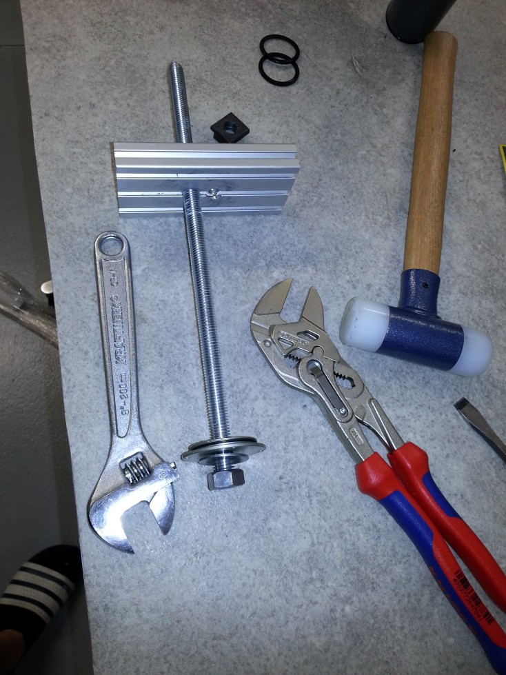

Our headset mounting tool xD

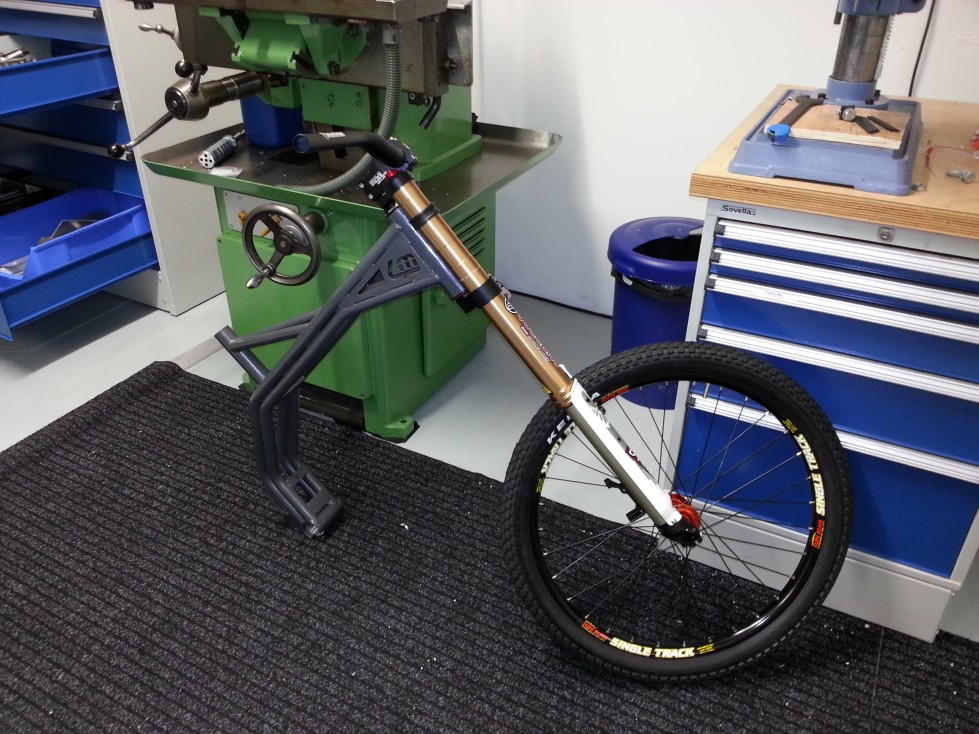

so far so good.. I will keep you on track about our build if anybody is interested..

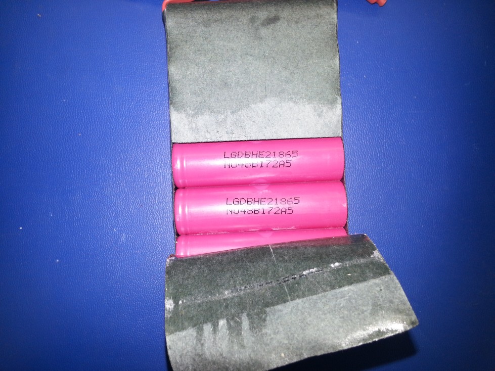

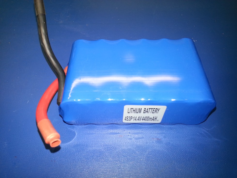

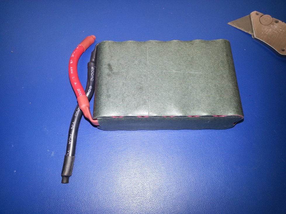

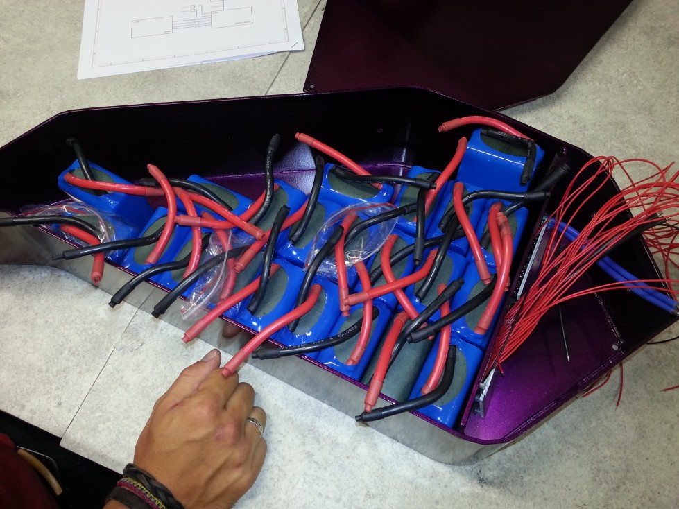

I just received the battery. 46 packs each containing 12parallel LG ICR18650HE2. arleady spot welded and equipped with a short cable/heat shrink wrap and paper guard
We will fit 22s12p in it. Controller can stand 100max, but the voltage shouldnt go over 95v... so 22s is perfect.
That means, when fully charged it has 92.4V and 30AH (that should drop to 27AH after 50 cycles and then stay constant for a while)
I dont relly know why they put the 4s3p label on it... maybe due to shipping restrictions. It is a 1s12p configuration

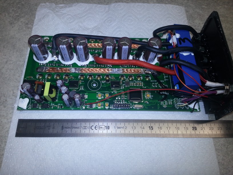

there's still plenty of space in it... perfect to fit the bms&controller

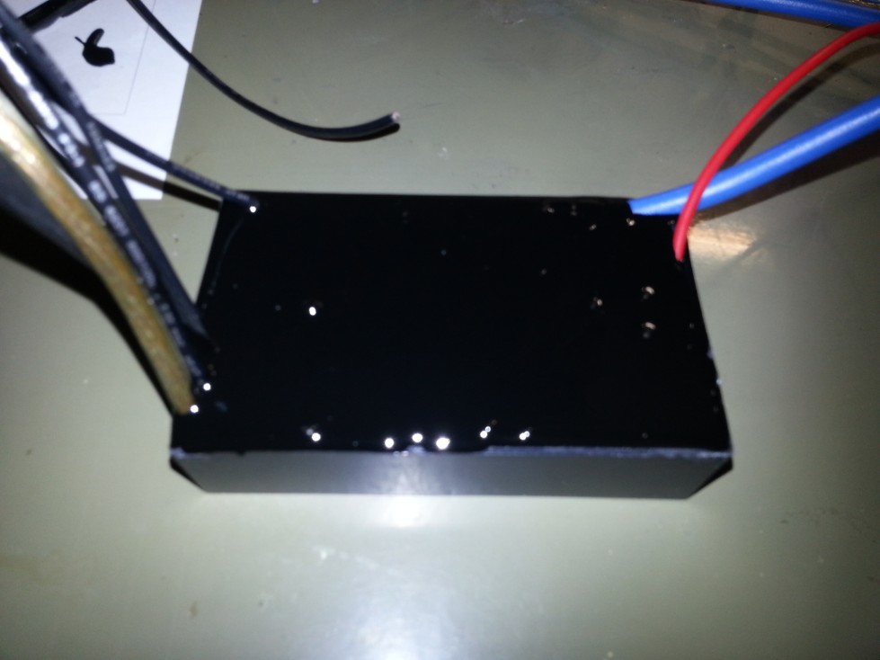

Ans here's the main switch. I know its quite badly soldered :p
And put in a box and filled with black PU resin
That was it for today... it could take some time until the next update

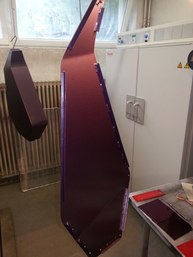

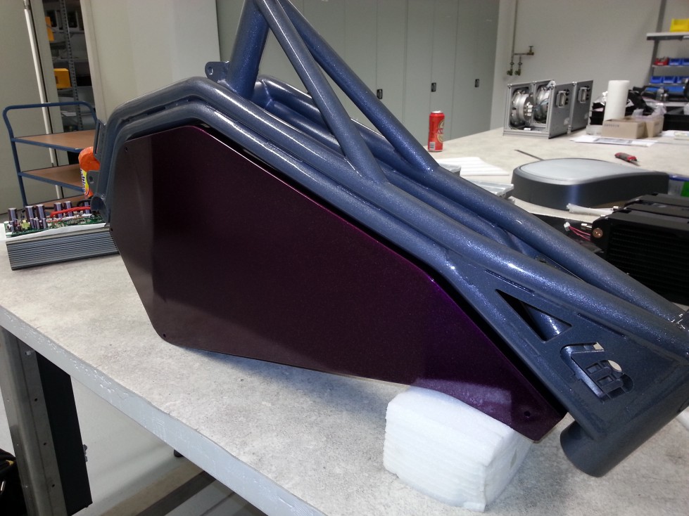

Yes the battery compartment is 3mm aluminium.

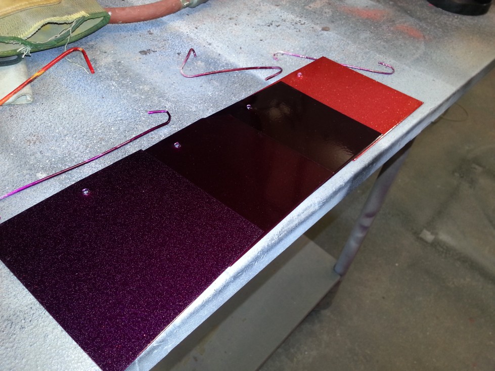

The painting process was just normal powder coating. But we couldn't do the full pre powder coating treatment due to the lack of equipment.
We did it this way: The stainless steel frame/steel swing arm was cleaned with a brush and the surface roughened with sanding paper (improves the adhesion of the powder coating)
then cleaned with acetone. The first layer was an anti corrosion primer, which was only needed for the steel swing arm,
but we put it on everything to avoid color/texture differences between the frame and swing arm.
Then we put it in the oven for 20min @ 180deg Celsius. After curing and letting it cool down, we applied another layer.
This time it was a mixture of anthracite gray and pearl glitter white with a quite rough and matte surface. Then again curing (15min@180 deg C) and letting cool down.
The last layer is a clear shiny coating.
My battery box (malbec/violet) also got a three layer coating. First the primer, then illusion malbec and rockstar sparkle jr as a top coat. (the latter two powders are from Prismatic Powders)
Powder coating is extremely wear resistant (if taken the right powder) and easy to do. We only used outdoor grade polyester/polyurethane powders.

The Forks are DNM USD-8. They are quite heavy and very stable... An adapter IS2000 to Postmount is also provided (for 203mm Discs)
The steering tube is designed to fit a standard 1-1/8" headset (i chose a semi intergrated one)
As far as i know moto forks have a bigger diameter...but its the best if you ask linukas directly.
I had a problem fitting the headset: The steering tube was not round (probably due to the welding) and it was very hard to install the headset...

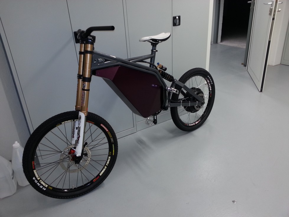

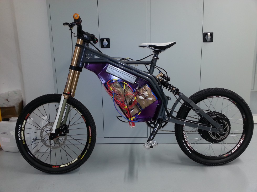

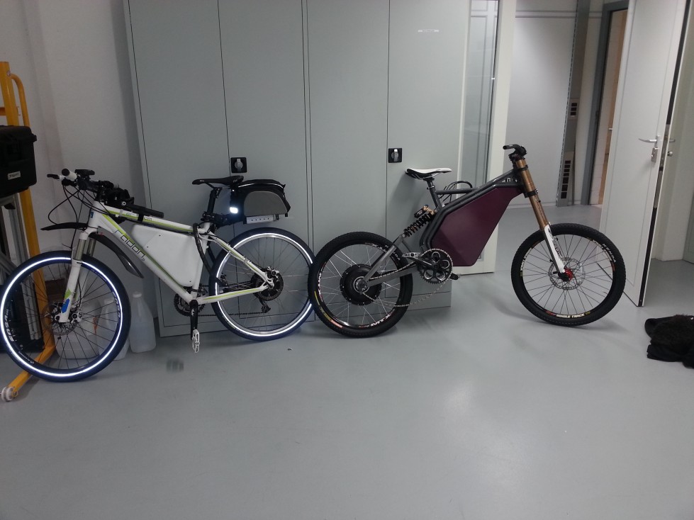

To keep you interested... old bike vs. new bike... the old bike is ca. 15kg lighter but the new one is built like a tank... even though I couldn't have a ride yet I already love it.
And the design.... its beautiful isn't it?
With battery but without battery protection, dcdc converter etc...
Looks like the seat is really far forward compared to the bottom bracket. It also looks like the frame is a medium as far as seat tube to head tube. Could you post measurements for us.
I realy like this frame but yeah, seat is in the wrong place. It will be really awkward to have the feet on the pedals not to mention pedaling.

Yes you're right.. it doesn't feel natural riding the bike. I'll see if I get used to it without problems... otherwise i will install a cranked seatpost and a shorter rear shock (200 or 220 instead of 240mm). That should make the geometry a little bit better.
Chuleo I see now that the black bike(new frame type) has a cranked seatpost.
Greetz Frank
I do... because with foot pegs i wouldn't get a license plate :mrgreen: But still... pedalling is only cosmetic or in case the motor dies or for very slow speeds.
It also seems with the seat set all the way to the back and a little bit higher it doesn't feel that unnatural anymore... with a cranked seat post it will be ok I guess.
