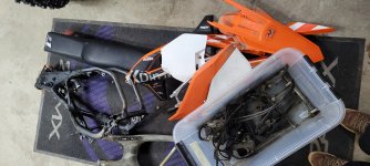

Since posts without pics are useless here are some. Please try to look beyond the absolute mess in my garage :)
This is what I bought as a donor bike :)
Pretty fast I assembled the pile i bought to see what I had.
Then used some stuff that isn't used right now from other bikes to get a rolling chassi
I got some measurements of the battery modules and a very rough approximation of the motors dimension (cardboard tube) and mocked up this to get a _very_ rough idea what it could look like.
I eventually got the motor and controler delivered and started playing with placement.
The battery modules. They are supposed to have a heat sink (water cooled) between them but I'll probablby have to mount them so that won't fit. My idea is to get another and use as protection from impacts.
I don't want to start cutting into the frame before I have a pretty firm idea of where everything goes. I'll try and get an air box to see if the controler will fit inside. My idea is to use as much as possible of the original plastics for better ergonomics and being able to use as much stock mounting hardware as possible. A tank would be great but I guess it will cost a lot. Toying with the idea to mould the tank from my FS450 in fibreglas but we'll see.
This is about as far as I have gotten as of now.

Motor has 1:2.35 gearing and I run it at 6000 rpm with 14/54 sprockets on 18" dirtbike tire with a top speed of 80 km/h.
If you cut the chain gard holder on the motor you could fit bigger front sprocket, otherwise 14 is about the biggest you can fit.
With 14 teeth front sprocket you would probably need to go down to less than 38 teeth on back sprocket to reach 130 km/h.

I had to take it apart yesterday to see what the inside looks like. Could be possible. Can't really figure out what the thread outside of the motor axle is for (besides perhaps a chain guard like you say). I'll look into that. Could be done with an angle grinder in worst case. I'd first like to get a proper, smaller, sprocket and see how it fits.
This is how the reduction looks like :)
The gearing is 19:45 so slightly worse that 1:2,35 at 1:2,37 :(
Put a 15t to see what it could look like.
