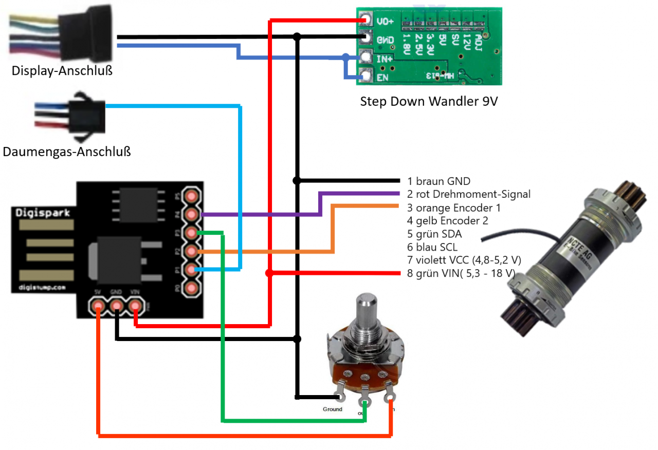

Looking at putting together a torque-controlled ebike, but have been somewhat surprised by the lack of alternatives to the Grin CA. I'm sure it's a nice piece of kit, but it kind of hurts to pay 250$ AUD+ for what is presumably 10$ of embedded hardware and PCB. All I really need is something that takes some inputs and generates a custom throttle signal from that.
Are there any existing alternatives? Worse comes to worse I'll either bite the bullet and buy a CA, or consider engineering one myself.

The main feature would be mapping a torque controller input to a throttle input (since I gather most controllers don't have a native way to support that setup). At that point it'd also be handy to monitor the rest of the system like power/speed etc, but that's really a bit of a secondary requirement since inline ammeter and wheel-based speed measurement are simple enough.
I guess supporting it in the controller would be fine too, but i presumed it would be more difficult than just having something in between to tweak settings with.
I had a quick look at MPe, but unfortunately it appears just as expensive, if not more so than grin :s (and I couldn't actually find a purchase link either). Maybe I'll just have to rig something up with an ESP32 XD

Do you have the torque sensing BB yet? If not, Grin has a smoking deal on a 127mm square taper torque sensing BB for $60 US. I Installed on on my current cargo bike.
I'm no electronics guy, but the torque sensor outputs two speed/cadence signals and a torque signal. Frankly, I'm not sure you need to used the speed signal. I know the CA does. But frankly, I wonder if just using the torque signal might be better. How hard you press the pedal would control how much assist you get. You'd just have to map the torque signal output to the throttle input. Given that the two voltage ranges are about the same, I wonder if you could just connect the torque signal output directly to the throttle input and have a working system. You could tune the sensitivity with a simple potentiometer.
OK, that's me just thinking out loud. I haven't tried this. It may not work. Or it might work, but poorly. It might be a stupid idea. But I guess my main point is that it doesn't seem to be a horribly complex thing. I bet there are any number of electronics projects out there that could be adapted to this functionality.

Which controller do you use? There are open firmware projects that allow the direct attachment of a torquesensor to the controller for Kunteng and for Lishui.
There is a project with minimal hardware (Digispark, 3.60$) for your purpose also:
This calculates the riders effort from cadence * torque on the crank and sets a proportional throttle signal.The assist factor can be set by the poti. But of course, this sets the speed, not the motor power, as there is no extra control loop for the battery current.
