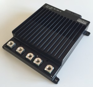

Anyone tried Hacker Q150 motor or Hacker HST-350 controller?
macribs
Jul 22, 2014
3,702
In the neematic thread there was a post about this motor/controller combo. Supposedly 20 kw peak power. Seems controller tops out at 580 A peak??
The more I think about it the more fun that combo sounds. But there are no tech info on their webiste, and their webiste is in German :(
Sucks for me as I don't know German language.
Motor:
http://hacker-industrial-solutions.com/qsl-150-45/
Controller:
http://hacker-industrial-solutions.com/frisch-fertigung-neue-hst-350-bldc-controller-serie/
I do like the design of the controller, from the pics it looks like it is almost build like a radiator. Should be great for air cooling when pumping high current into the controller.
If anyone got specs on these two I would be so happy. And if you tried one or the other or the combo pls let me know what is your feedback.
Don't even know the kv of the motor so hard to say what kind of reduction would be needed.
What you think, the real thing (20 kw peak) or just a hard core advertiser boasting the numbers to spark interest?
If this is real it seems on par or stronger then the Joby.

In short, hands off..
Those motors and controllers are primarily intended for propulsion of aircraft propeller. In this aplication there is complete different torque load than in land vehicles = almost no torque peaks. Yes this motor design has unbeliveable torque constant (0.1Nm/A) for such small and lightweight motor but it is almost useless for land vehicles due to extremely fast overheating of the motor under continuous load.
For the current example. Q150 motor have a 4350rpm no load speed at 50V, and I am quite sure that under heavy load it will rapidly fall down to 3500rpm (probably much more). From datasheet it is not clear If the HTS350 controller can do 350A peak or continuous, but for peak 350A it is ~35Nm peak torque for Q150 motor and this gives me about 13.3kW of power but definitely for only a few seconds due to motor overheating. For 20kW you need at least 600A peak into the motor.
Continuous power of this motor seems to be in ideal case 4.3kW and 11Nm but I guess it will be only a half of it under real life conditions.
Yes I know it is intended for aircrafts, so are various other small motors that have been used successfully on e-bikes.
Additional cooling might be required as well as maybe a jackshaft with a slip clutch. Cooling could be additional fan or fan mounted on shaft.
The controller has 580 A peak current. 350 continuous, sine wave FOC.
According to Hacker that motor and controller combination is used in several go kart builds that tops out at 20 kw.
If the Q150/HST 350 combo is working great for go karts it seems it should work well for e-bikes too?
If you think about "standard "e-bike use the yes it will work well. I mean an e-bike with the average power of about 500-1000W even with "20kW" peaks (but it seems to me impossible to pass this power on the road without slipping the wheel). But if you think about 5kW continuos use with many 20kW peaks then you will be very likely disappointed.
And yes if controller can give 580A peak current then it seems to be real to do 20kW for a few seconds.
Well for e-bike usage peak power for 3-4 seconds will be enough, especially at those numbers. 3-4 seconds would propel you to top speed.
I am not ready to dismiss such a setup right away. From the top of my head I can think of several Astro builds, 10080 builds and even a few 150cc helicopter motors being used for e-bikes at very high peak power. The revolt motors are also powerful, and Neematic pushes 20kw peak from 160 pro.
Thing is that peak power will only be for short bursts, and if go karts work well so might e-bikes on that combo. Cos I realize that kart tracks will be very different from e-bike usage, as bikes will need to do some climbing as well. But with the right gear ratio that should be all possible.
One thing is still unclear, the price for this combo. If this is really high dollars I don't think I will have the guts to try it out. But I will wait for the price to be known before I know yes or no.
Might even be that the HST 350 controller would be a sweet match for ie the Revolt 160 pro.
