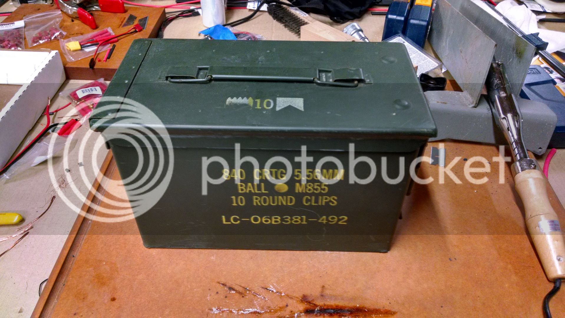

I finally got my Recycled Laptop Cell Battery soldered up. I packed them into 3 bricks of 4S each and wired in balance leads, so I can pair them with my 4S LiPo's and charge/balance them all in parallel.
The Laptop Pack and the RC LiPo combine for a total of 26 AH at 12S (44.4V Nominal)
They fit snugly in a 50-Caliber Ammo Can I picked up at the Army Surplus store. - Once I have a rear rack mounted to the frame, I'll be testing for range. My best guess is at 14 Watts per mile, I should get around 75 miles of assisted pedaling, which is probably longer than my ass can handle.
