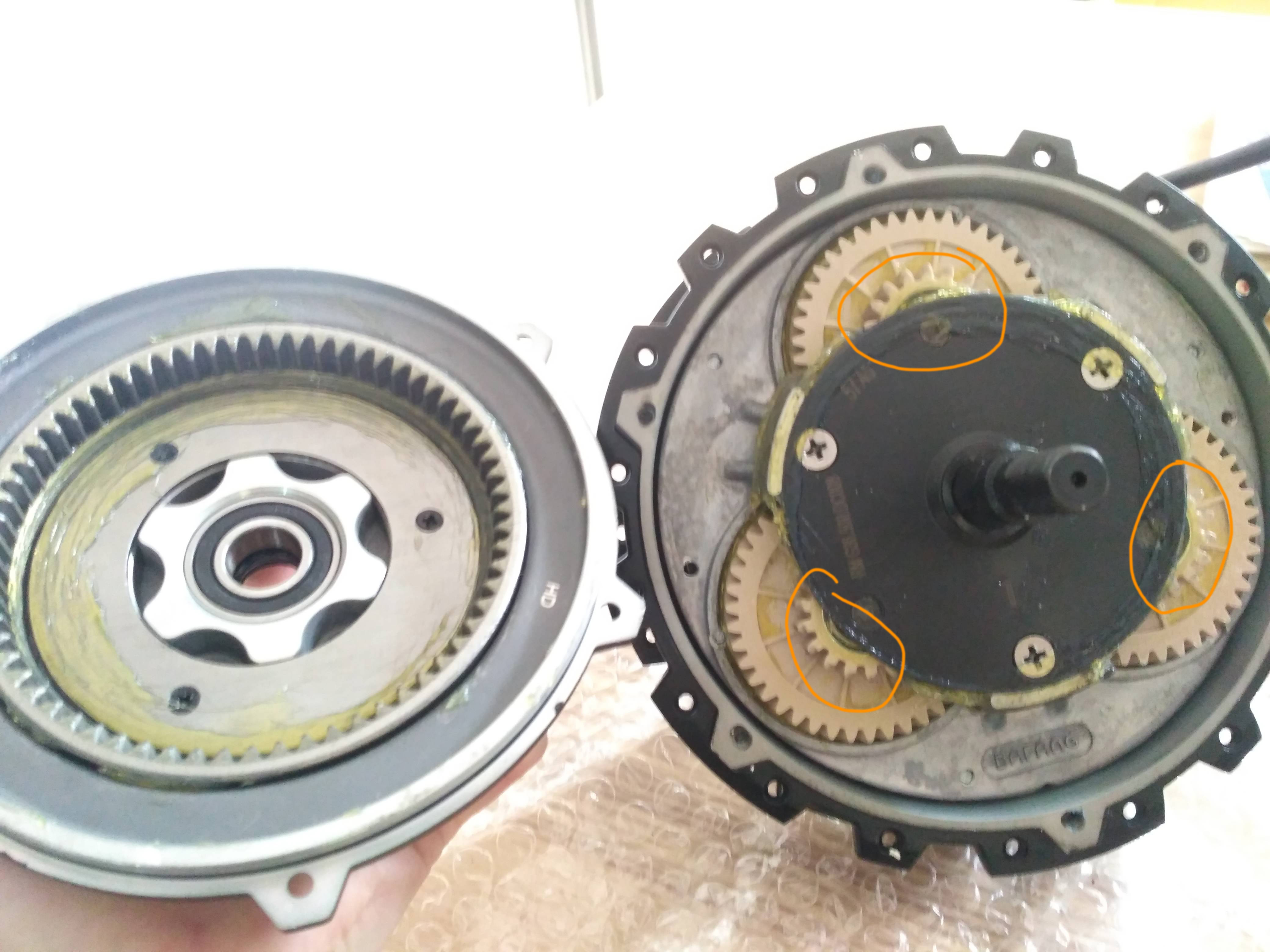

I managed to melt / break my gears circled in orange here somehow after 1500mi commuting here in Portland. Anyone know where I'd find some replacements?

Wendy at CNEBikes was also able to source G360s when I was originally trying, they didn't stock them so it was a 40 day lead time. You could try there for gears.
What power levels where you running by the way?

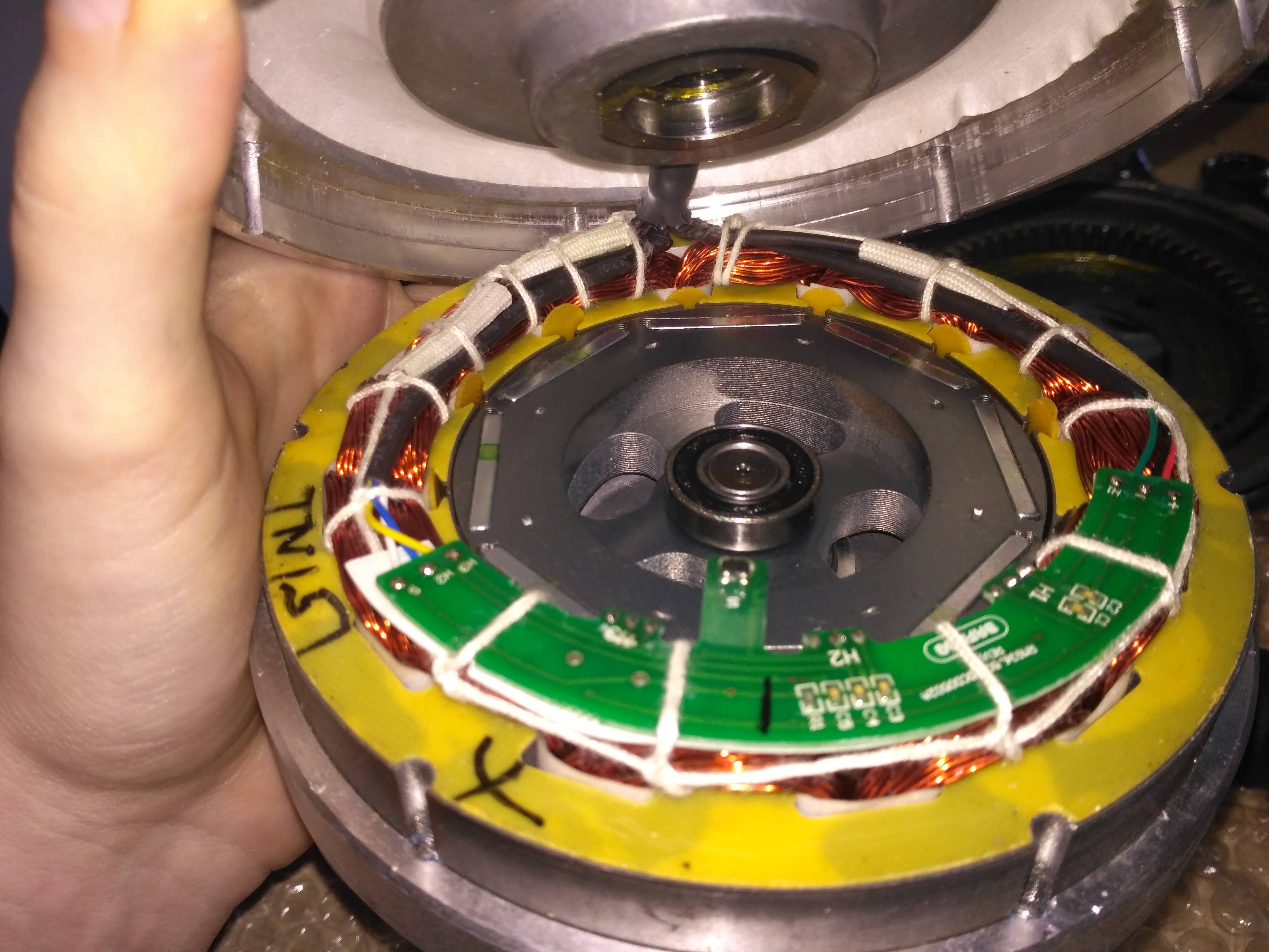

hi .i am stuck here. i don't know how to open this , to reach the internals to change the cable

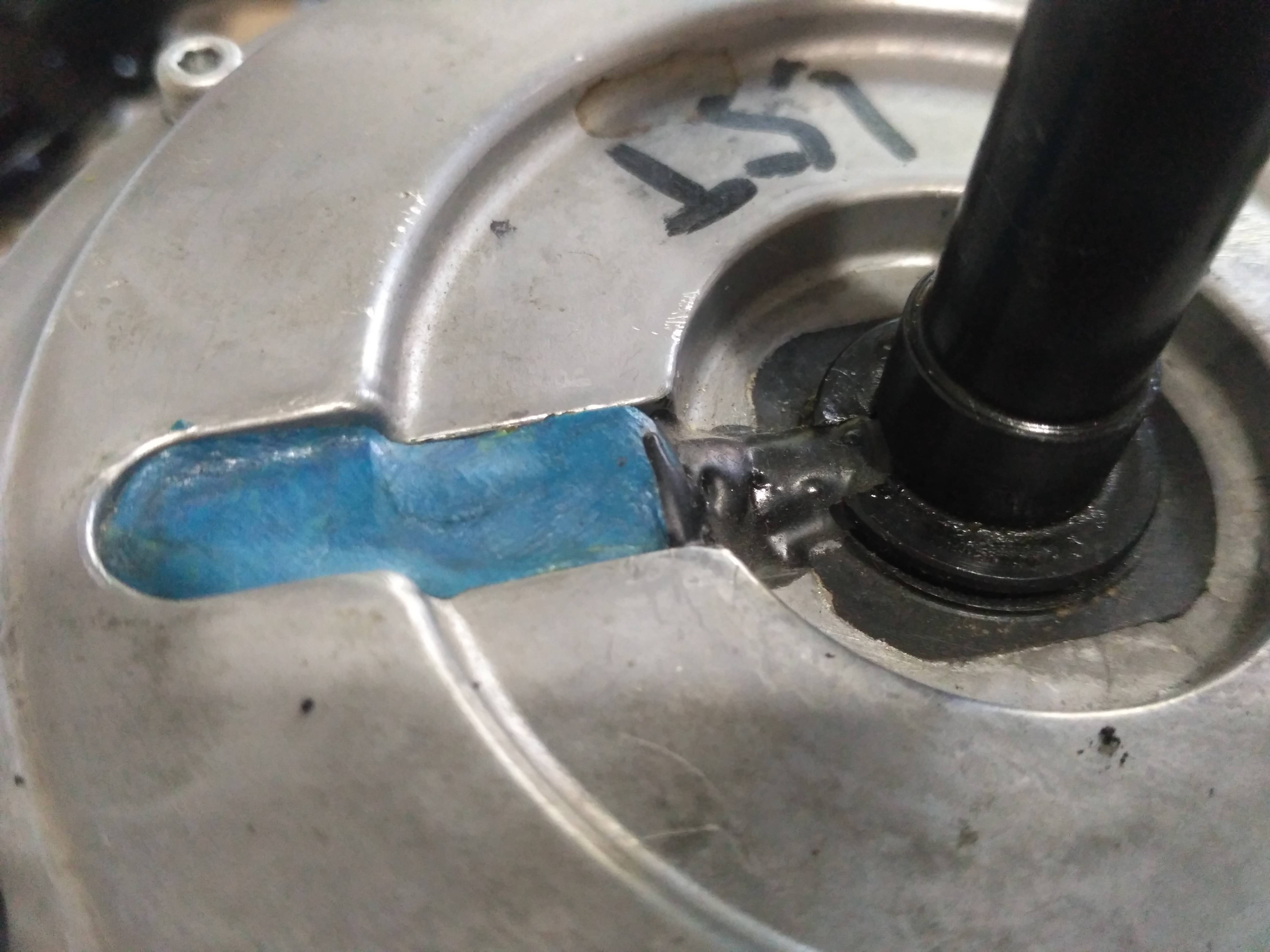

Wil said:
Wiring is potted on
Finally at the internals
That piece you are holding is the top piece in the picture here with the wiring. I never got it physically as separated as you appear to have it because
A: The wiring is potted to this top case
B: The wiring is wired to the core wiring, which is stuck in the other half of the case.
So I only angled them apart for the photos.
From where you are though all that should remain would be to remove the potting, and then I THINK the cable will just pull through.
Looking at your picture closely I can see you still have the speed sensor visible through the cutout in the top case.
On mine this was tied to the stator, and the stator stayed in the more inner half of shell when I separated the two halves of the wiring shell.
Is the thing you are having difficulty with that the stator is instead stuck in the more outer half (with the axle shaft that you are holding in your image?)
yes, in my case, the top case (with the speed sensor) is stuck with the stator , and i cannot reach the internals. i want to open the two parts in the last picture.mine are stuck together.
