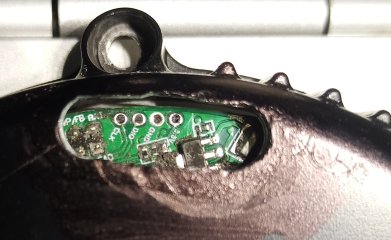

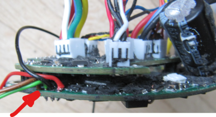

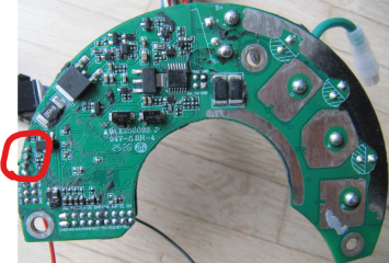

I guess that means full un-potting of the controller is needed, and then removal of the connector pcb to get access?
No, if you have disassembled the controller from the housing, there is enough space to solder in the wires for the debugger.

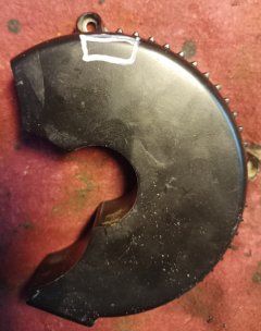

You can try to mill a groove into the aluminium housing to get access to the four pins (+3.3V, GND, SWDIO, SWCLK) from the bottom. But I never tried that.
And of course this not necessary for a standard user at all, as you can flash the firmware non invasive by the BESST/Canable Tool and the display connector ;)
The groove could look like this, even a bit smaller. The hole for the fastening screw gives a good orientation.
The distance from the surface of the housing to the transistor is about 6mm, so you should not mill deeper than 5mm.
