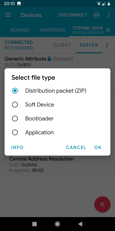

DFU is working!
Normal Startup (SW102 advertising UART over BLE):
Bootloader Mode (Hold Power + M for >5 seconds)
Transfer of new firmware:
Nick said:
DFU is working!

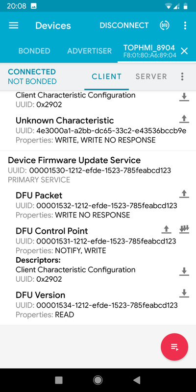

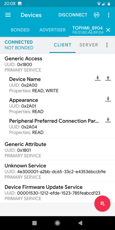

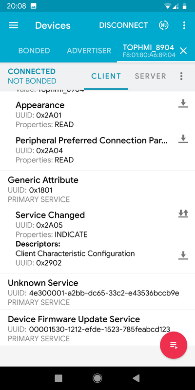

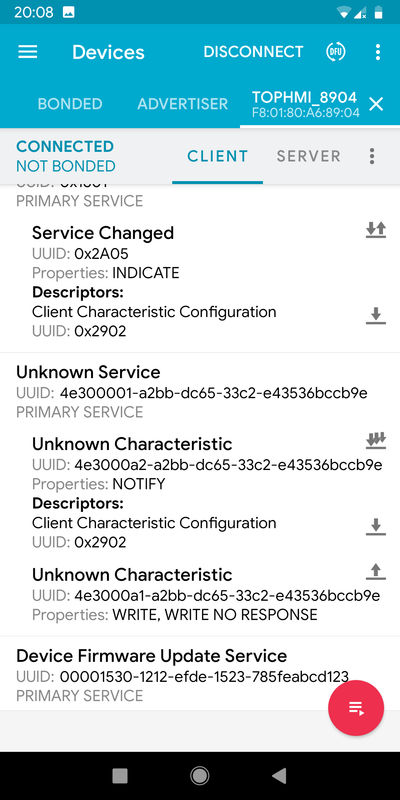

Finally I received my sw102.
I noticed that out of the box the dfu service is also available. Would this mean that users could flash our firmware (& bootloader) without the need of opening the sw102? (That would a huge advantage).
The coming days I will start to experiment with the android app
Hard to tell. It depends which bootloader is on the device. If it's based on the Nordic nrf5 bootloader, it requires a signed zip file. So without the private key you can't update anything. I assume this bootloader also accepts only signed packages. So for now you have to open the device and flash our own bootloader.

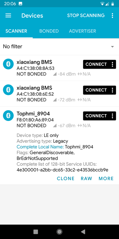

I did power on the SW102 I have here that I bought from PSWPower and has the original firmware. Bluetooth does work as seen on the NRFconnect app. Please see what you can find... can we find the company looking at the IDs on the screenshots??
The device name is "Tophmi_8904". Topology Human Machine Interface, since the company is Topology Tech?? -- I don't see it listed on Bluetooth site..... or maybe I didn't search correctly??

Mine has the device name "TOPHMI_A001" with DFU available.
I didn't see neither a characteristic containing the name of the corporation.

Tried to flash your bootloader .hex with DFU, but failing because it is also requesting for the "extended init packet"Screenshot_20190507-190459_nRF Connect.jpg
