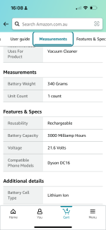

Simultaneously connected in series and parallel in a 4s4p configuration
Those are the specs so I'm looking at a combined 86.4v 12000mAh .
Is my maths correct?
Also would this be okay to power a e-bike at 72v? What drew me to this was the minimal form factor of the batteries which can be very discretely mounted additional bonus is I most likely should be able to directly connect the battery using a hailong style battery mount terminal. Looking at less than 2kg if the above specs are to be trusted .

21.6/ 6 = 3.6V 6s x 4 = 24s
I believe that the 21.6V is nominal voltage so it could well exceed the voltage limits of many 72V controllers. 24s fully charged is 100.8V.
340 g x 4 =1360g x 4 = 5.440 kg

What floydr understands, but didn't explicitly say, is that you can take 4 of those packs and arrange them in series for 86.4 volts nominal and 3 amp-hours, OR you can arrange them in parallel for 21.6 volts nominal and 12 amp-hours. You can't do both, unless it's 2 in series and 2 in parallel for 43.2V nominal and 6 amp-hours.
I've used those Dyson vacuum cleaner batteries before, but only to make portable powered speakers. They only contain 6 cells of 18650 format, so you would need a lot of them to power a bike. Putting four of them in series would create a risk of destroying their BMSes and rendering them useless.
Worse than useless. Sometimes dangerous,
When you put batteries in series, you need to make sure that the BMS in each battery can hold off the full voltage of the entire stack. in case it switches off. For four DC16's in series, that is 24S which is about 100 volts at full charge. It's highly unlikely Dyson or any clone battery makers used 100V transistors into a 21.6V BMS.
It's not a theoretical EE exercise either. It's a real limitation. There was a poster on this forum that posted about putting two 48V packs in series. He must have switched one off. That;s 110 volts across the BMS and it popped. Unfortunately it shorted out the BMS, so he lost all protection. He posted later asking why the battery caught fire
Your DC16's don't have switches, but a BMS can turn off for overcurremt, low voltage etc, All you need is one of them to do so. and it's likelyto be damaged.
