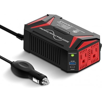

Option A: On my bike, I can connect via xt60 a ~300W inverter and plug in the Bosch charger to charge her battery off mine. I can simultaneously connect the solar to my battery, meaning that some of this would pass through. I already have a step-down converter to provide 12v that I can connect via a splitter cable, so this would basically involve getting an inverter, and carrying her charger. Pro: this seems pretty straightforward, but the inefficiencies here are pretty big. I don't know how big but the cost of converting from 48v->12v->120vAC->36v seems like a huge waste. Not sure if I'm over-optimizing here, but this just feels like a lot of steps.
