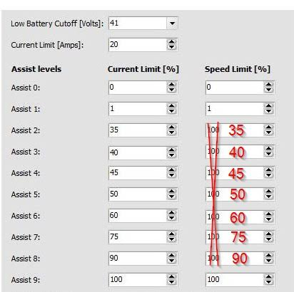

Thanks for sharing! Was also looking for this.. Does it fix the PAS level program error? Some BBSHD controller have this error, where you program the thumb throttle levels to 100% and you can maximum use the percentage of the current PAS level.. See: https://endless-sphere.com/forums/viewtopic.php?f=28&t=100064&start=125#p1615713
