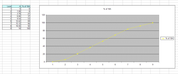

I've recently bought a bafang BBS02 500W 48V motor for a cargo bike but sometimes when I'm carring my kids i've some trouble going up hill. I could use a bit more torque... I read somewhere in the forums that basically my 500W version of the BBS02 is essentially the same motor as the 750W but with a controller that limits the current (A) to 18A. I got a programming cable and i've tried to increase the current to 25A to get that extra power... unfortunately my firmware doesn't allow me to go over 18A.

Have you tried setting "Keep current" to 100%?
This appears to be factory default, 60% is too low = 10.8A.
10.8A X 48V = 518.4W.
You want 100% of:
18A X 48V = 864W
pedalcont-jpg.170641

Even with my 36V "250W" BBS01B motor controller limited to 15A, I had no trouble dragging a combined weight of Homcom bicycle trailer + cargo + me + 20" wheeled Dahon Helios P8 2006 folding bike = 180kg+ up steep hills. It's even easier now with the controller set to 18A. Slow but never failed at 15A, faster at 18A. Here are my firmware settings, you can see "Keep current" is 100%, and I've been cautious above 15A, in case my battery explodes. My Level 1 is sufficient to overcome motor pedalling resistance. If you don't set "Keep current" to 100%, assistance starts high and diminishes quickly, in your case to 60% of 18A, which sounds practically useless for your purposes.
