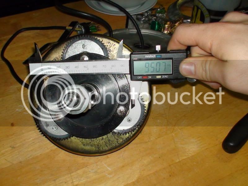

It looks like I am in the market for replacement gears after 1300 miles at 48V/30A. Look at this:
Anyone know if the new composite gears for V2 will work in the 400W V1 version and where to source? I'd also settle for 2 nylon and one steel I guess.
Are those torx screws securing the gears and what kind of grease is in there. Thanks.

BMC USA told me that the V1 and V2 gears are the same size. The composite ones will work in the V1 but will be noisier. Seems okay to me as long as it doesn't break.

I am in the process of trying to obtain the composite gears directly from BMC for Snowranger. I will get some extras in stock, and have them available. I will post again as soon as I have them in hand.
Just a note, I think that 30A at 48V is too much for the V1 motor. The max power I would recommend for the V1 motor is around 1,000W (i.e. 48V at 20A). They are not designed for more than that..... But for people using them within that range, we've not had any reports of blown gears yet...

I opened up the V1 and V2 side by side tonight to compare gears. Both are same size... but the V1 gears are white nylon (like in your picture), and the V2 gears are green, presumably the composite (though BMC has not been forthcoming on exactly what the composite is). It would be interesting to do some destructive testing on both, but right now I can't afford to do that....
Wiring in the V2 is also beefier.

The most I have seen with the watt-up is 1300 watts or 26 amps into the infineon controller, but yes, that is too much for the nylon gears over the long run. The hub has never gotten hot at all according to the temperature sticker, but I think that mechanical shock on acceleration did them in. Cycle9 has been very responsive in helping me out. Hopefully, these new gears will breathe new life in.
BTW, any one know the type of grease in there and what kind of screws are holding the gears on? I haven't been able to separate things far enough to get a good look.

The grease looks like standard automotive/gear grease. I have queried with BMC to see whether I can get more specifics on it.
I will also get more details on what you need to do for gear replacement. Sorry it is taking a while, I am pushing them. But I suspect it may involve using a bearing press to separate (I don't have an open motor in front of me, but that's what I concluded last time I looked). An automotive bearing puller might be made to work.
