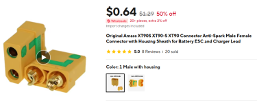

Why not use some of these?
Great antispark connector, my whole fleet has them.

You could just use xt90's. And you can get xt60 to xt90 adapters super cheap.
It would be more compact and less complex than most antispark solutions i've seen out there.
I have 2 ebikes, both with XT-60's currently. I already have an anti spark solution. It does not make sense for me to switch to XT-90S with adapters to XT-60.

My Ego BMS only works when charging (learned that here). I use anti-spark xt90's like Neptronix. You can't see the other end in the controller bag, it's a standard xt60. If you can solder, a short pigtail adapter is easy to make. I like the larger xt90 anti-spark connector, it's easier to grab when plugging and unplugging.
The pic is from one of two identical etrikes just completed. I joined the forum to learn how. Thanks to all!
