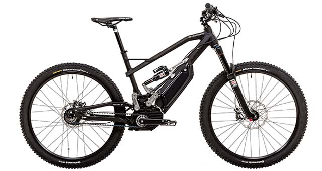

Bosch Mid drive
integrated into swingarm to balance weight
a VPP'ish pivot
belt drive
400wh pack
Magura MT7 hydro brakes
Rohloff Speedhub
Rockshox Pike fork
Pretty dope.
Looks kinda like they hacked up a subpar frame and welded on a nice looking bottom bracket.
It just looks hacked together instead of being designed from the ground up to me.
Car companies don't seem capable of making a bike look remotely as nice as their cars.
The bottom of the bike is artful, but the top looks like something from walmart.
130km/80 mile range with a max speed of 45kmh/27mph on 400whrs?
This assumes that the electric motor is pushing maybe 20-25 watts and the rest is pedaling.

I think it looks over engineered, and most likely will not be as stiff as it should be (low profile rear end). I'm quite surprised that Nicolai Kalle is working with them.
The Bosch drive unit has a torque sensor, shifting is no problem with this system.
You need 500W at the wheel to go 45kph, this is 600W Battery power (assuming 83% total drive system efficiency), so what you need is 600Wh/45km ~= 13Wh/km battery energy or 500Wh/45kph~= 11Wh muscle energy (assuming 100% eff)
you get 400Wh*0.83 = 333Wh to the wheel
for 130km you need 1430 Wh at the wheel. 333 Wh come from the battery (23%) , 1097 Wh from your legs (77%)
So there is 115W from the motor and 385W from your legs, which you do for 130km/45kph = 2h 53min, sound like you are neil armstrong, dude!!
IMO it should be the other way around, 115W from the legs are fine. So the battery must be 1097Wh /0.83 = 1.5 kWh to faithfully meet that claim

I would love to see the suspension pivot after a couple of decent drops.
Seems a bit unfortunate.. really missed an opportunity to move the rear suspension to the rear triangle to double (potential) battery capacity.. not a fan of the battery by default being out of the inner triangle.
And the price tag... would rather a Haibike I think.

To be fair, they list 45 kph as the maximum speed, and maximum 130 km range. Electric car makers, including BMW, also talk about their maximum speed and their maximum range. Obviously, they don't mean at the same time. But people want to believe the best, so many have been disappointed when their electric car doesn't go as far as the EPA claims.
The car companies, and the bike makers, are setting themselves up for failure, with those best case numbers.

But for real 600W = 45km/h? Sounds a bit fast to me?
Is that frame design basically a unified rear triangle system, found on the cheapest mtb's? If you ever have to pedal it its bob up and down something awful? :shock:
Most likely not, the description says that it's neutral to the power delivered, and will always work, regardless of the load.
Nicolai Bikes were always very special, sp I expect this to be good, even if I don't like the looks.
Hey, wasn't Heisenberg the father of the uncertainty principle (as well as IIRC, Walter White's alias)? What can we expect from a company named after him? Seriously, though the urban model for about $4K US seems enticing. Probably won't make it to the US for years though.
Re the unified rear triangle, yes... the dual parallelogram rear suspension IS a type of URT (unified rear triangle), but not swinging from a single pivot. Its a whole different beast though.Careful design of the linkage neutralizes the chain pull effect, and allows the rear axle to not just swing a semi circular path around the pivot, but lets the wheel move upwards and backwards at the same time. Here there is no chain (or rather belt) pull as the BB is part of the rear unit...but all the other designs I've heard of like that were unpopular for the way it felt like the pedals were jerking around under your feet as the suspension moved... maybe they got that worked out.
The rear suspension works fine, really fine. No matter if you are pedaling, sitting, standing... it works fine. You can not compare with the old unified swing like a Trek Y33 (had one, years ago) - forget about that.
