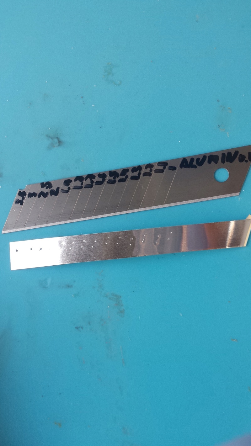

It seems plating the copper helps Somehow. I just defeated 0.2 plated copper. In pure state the boss didn't weld it.
3s has no effect on copper. I used 4s. I did 0.1 pure copper so far. 0.2 plated is a great achievement. Double conductivity plus oxidation protection.
I just tested aluminium 0.1 it sux
it is a delicate princess. Did a 3s lipo test. Low time flux has no effect and increasing times makes holes. Totally worthless and disappointing. I have found a very cheap source for 0,2 but i don't think i will bother. 0.2 will probably not make holes so easily but copper is much better and easier to weld.

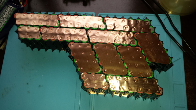

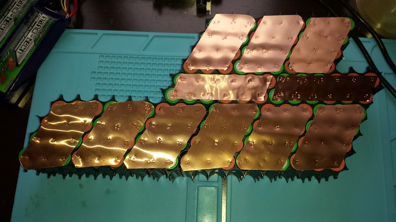

I have been doing a rather big pack today with my boss welder. A triangle 22s 6p pure copper pack.
the night has caught me. Let's call it a day. I will continue tomorrow
More pics and maybe a video when done.
