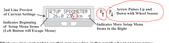

I bought a new CA V3 from ebikes.ca and 8000 Watt controller with WP8 plug from Hi-Power Cycles. Currently running everything off a crystalyte x5403.
I set the pole qty and wheel diameter in the CA. First test run and I find out the speedo is not working.
Trying to do some trouble shooting and I can see the arrow in the "SETUP SPEEDOMETER" menu is pulsing up and down with the motor being turned by hand. See photo below for quick reference.
I hooked up an older CA V3 via WP8 to JST connector adapter and still no dice with the speedo, so it isn't the CA.
The motor runs flawlessly and silently with the sinewave controller, so I know the hall wires are wired correctly to the controller.
After I source a 500 ohm resister, I am thinking about jumping a hall signal wire directly to the speed pin 2. But, before I proceed, I would like to see what other opinions are out there. Looking for some help on how best to trouble shoot this.
