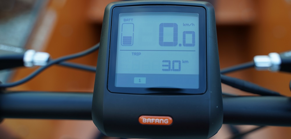

I have bought an Cargo bike from Vogue. The Carry 2.
I am in the EU, and I am a bit disappointed by the lack of torque of the engine . Speed is not a problem. The limit at 25 km/h is ok for me as I ride mainly with the kids in the city. But I need more torque, especially that I am in a hilly area and got in some trouble are when the bike was loaded with 2 or 3 kids
I have tried to unlock the display, but apparently there are no setting for the torque. Only max speed.
1) How can I adjust the torque? is it capped?
2) everytime I change gear (nexus 7), the M400 cuts a micro second (I assume to allow the gear to change without too much torque into the hub) is this normal?
You'd change the gearing between the motor and the wheel. For higher torque, you get lower speed.
If shifting into the smallest chainring at the front and the largest one in back is still not enough torque, you'd need to change one or both of those until it is enough.
Bigger in back, smaller in front, gives more torque.
Smaller in back, bigger in front, gives more speed.
It's directly proportional.
If you need the top speed you already have, then don't change the front chainring (if there is only one), because you need that to reach the top speed. Just change the largest rear sprocket(s) to even larger ones, proportional for the amount of torque you need to gain vs the size of sprocket you already have.
If you don't need as much speed as you have now, you can change the front ring to a smaller one, and if necessary a larger rear one.
If it has a Gearsensor installed, then yes. This is a device normally placed somewhere along your shifter cable that reads when you shift.
