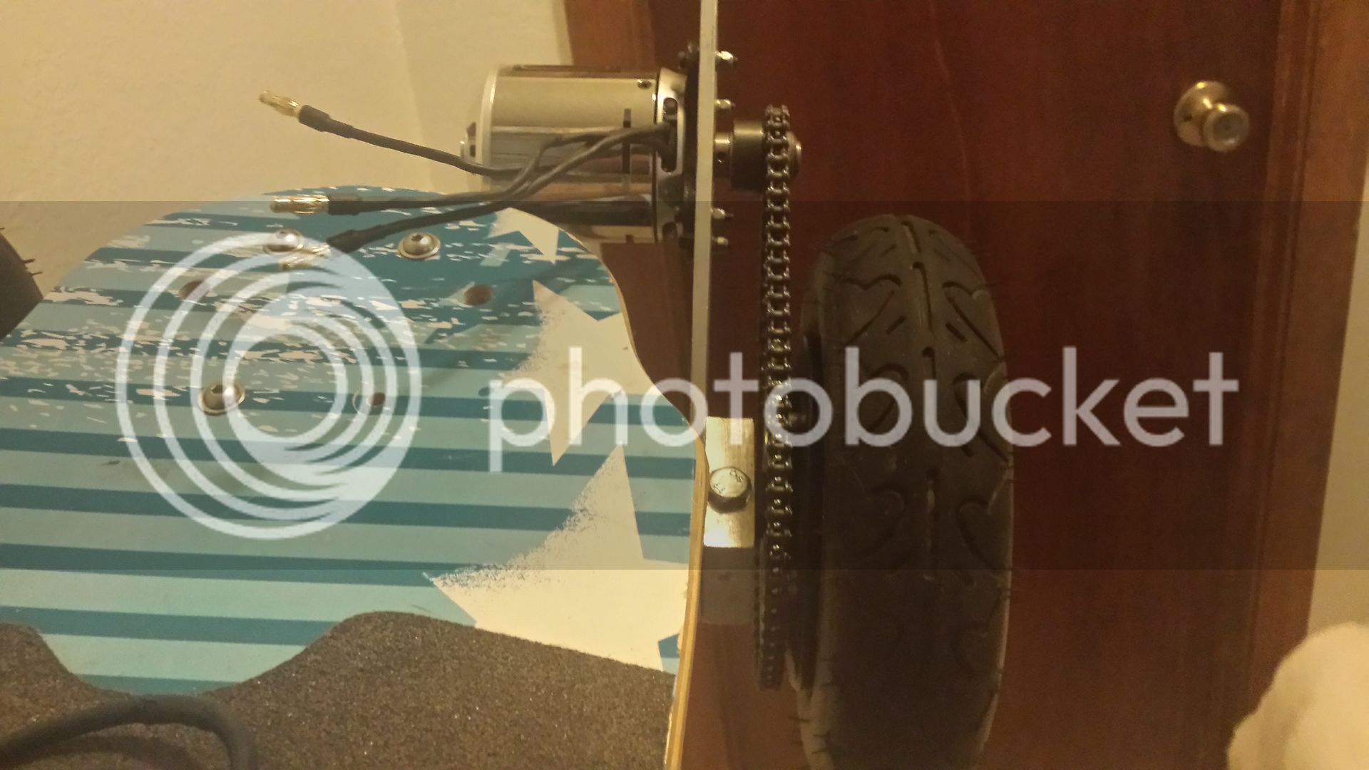

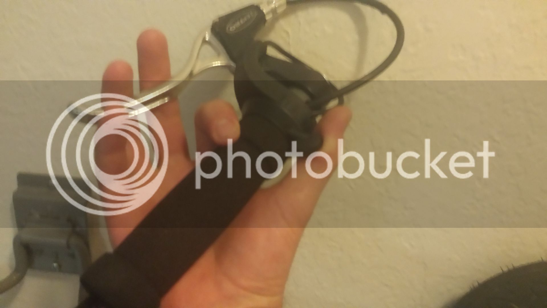

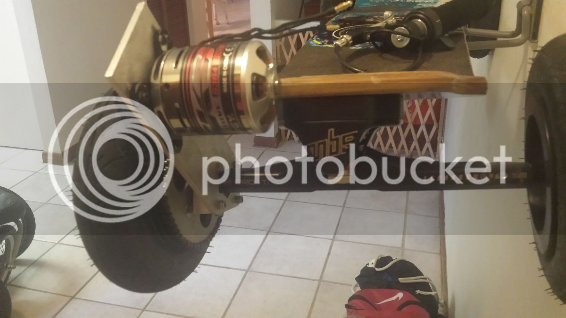

After a long hiatus, I have finally picked this project up again and bought everything I need to get riding . I have made some progress over the past week and am hopefully getting close to finishing my board. Still left is to fix the motor sprocket to the motor shaft, mount the esc, and connect either a servo tester or microcontroller between the hall throttle and the esc. Here are some pics of what I have done so far.
