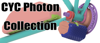

Hi all!
Have been working on this project last weeks and thought to share it if someone else is interested.
CYC Photon complete motor assembly with brackets, spacers and crankshaft. Some other random 3D models related to that. Like a simple bash guard for the motor.
Feel free to use for your own designs:
CYC Photon Collection by Bent Derailleur | Printables.com
And I also made this settings sheet to be able to record the settings and compare to stock ones just by a glance, it is an Excel sheet in zip file. See attachment.

Cool. Don't know if I can make use of this, but nice to see.
Thanks mate, glad to hear!
If you ride offroad I can really recommend some bash guard. I have hit rocks many times with my BBS without some at all. But would not like to do it with Photon. That was main reason why I did this.
And to make sure the community stays alive, I noticed there are not too many designs for this motor. It deservs better! :)
